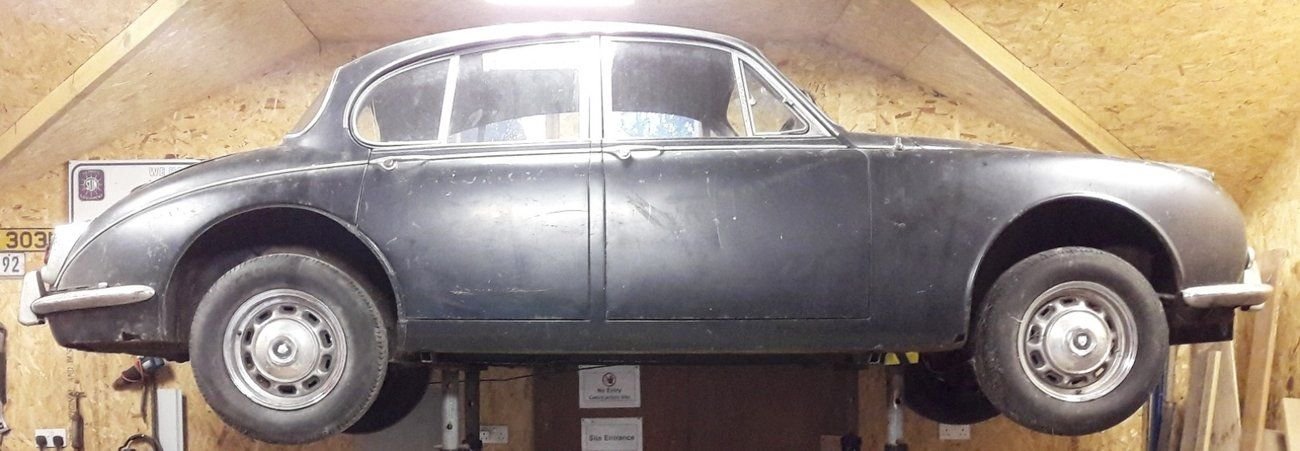

https://www.jaguarforums.com/forum/m...on-mk2-209719/
https://cimg1.ibsrv.net/gimg/www.jag...9ac1b7815a.jpg
A picture paints a thousand words.....

are they series 1 wheels?
Old Oct 27, 2018 | 09:22 PM
Glyn M Ruck's Avatar
Posts: 5,546
Likes: 1,493
They certainly seem to be. Ask matchlesspat the OP.

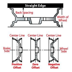

It is obvious that the stud pattern & centre bore is correct for a Mk2. If they are competition wheels you need to find out what their Offset is for anybody to answer this question.

Trial & error with offsets is not a good idea especially upfront as you change the scrub radius. The more positive you go with scrub radius by pushing the wheel out (reduced offset) the more detrimental to handling even though people like the stance. Negative scrub radius from design is more benign. You also change bearing loadings etc.

Understood. I used to run our racing team! I'm not talking about tyre size. I'm talking about offset & scrub radius. The centre of a wider tyre is the same as a narrow one so scrub radius does not change with tyre size. It changes with wheel offset.
I always run negative camber on my cars & push the castor a little. BTW ~ only wider tyres within reason. What matters is the weight/contact patch ratio for sensible road compounds. Too wide can have adverse effects on handling & grip.
