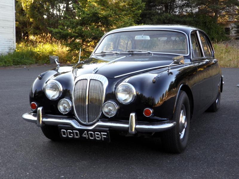

I don't have a recommendation for you, unfortunately. I actually like the dual point set up in my 1968 V8250 driver and it runs great with them. I may drive mine less than you, however...maybe 2,000 miles/year. That means I have to change points every 5 years or so, but not a big deal.
