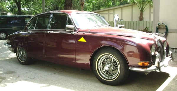

I assume it's for a S type ?
is the antenna hole near the "A" post ? (rear of the front wing?)
if yes, I also assume you know about the round openings behind each front kick panel, where you can install 7½" round speakers and also access the antenna, which will need a "P" bracket support halfway down the wing, and where there is also a convenient bolt hole for the bracket.
in my S type, the antenna is located on the passenger side, rear of wing, per the yellow arrow in the picture. I can access the wiring and mounting from the hole in the kick panel.

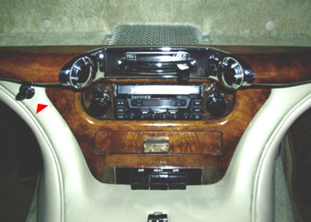

my car was originally sold in California and came with a power antenna.
the antenna switch is located to the left of my radio in the center console, a Lucas toggle switch with chromed nut that matches all the other toggle switches.
see red arrow in the picture.
