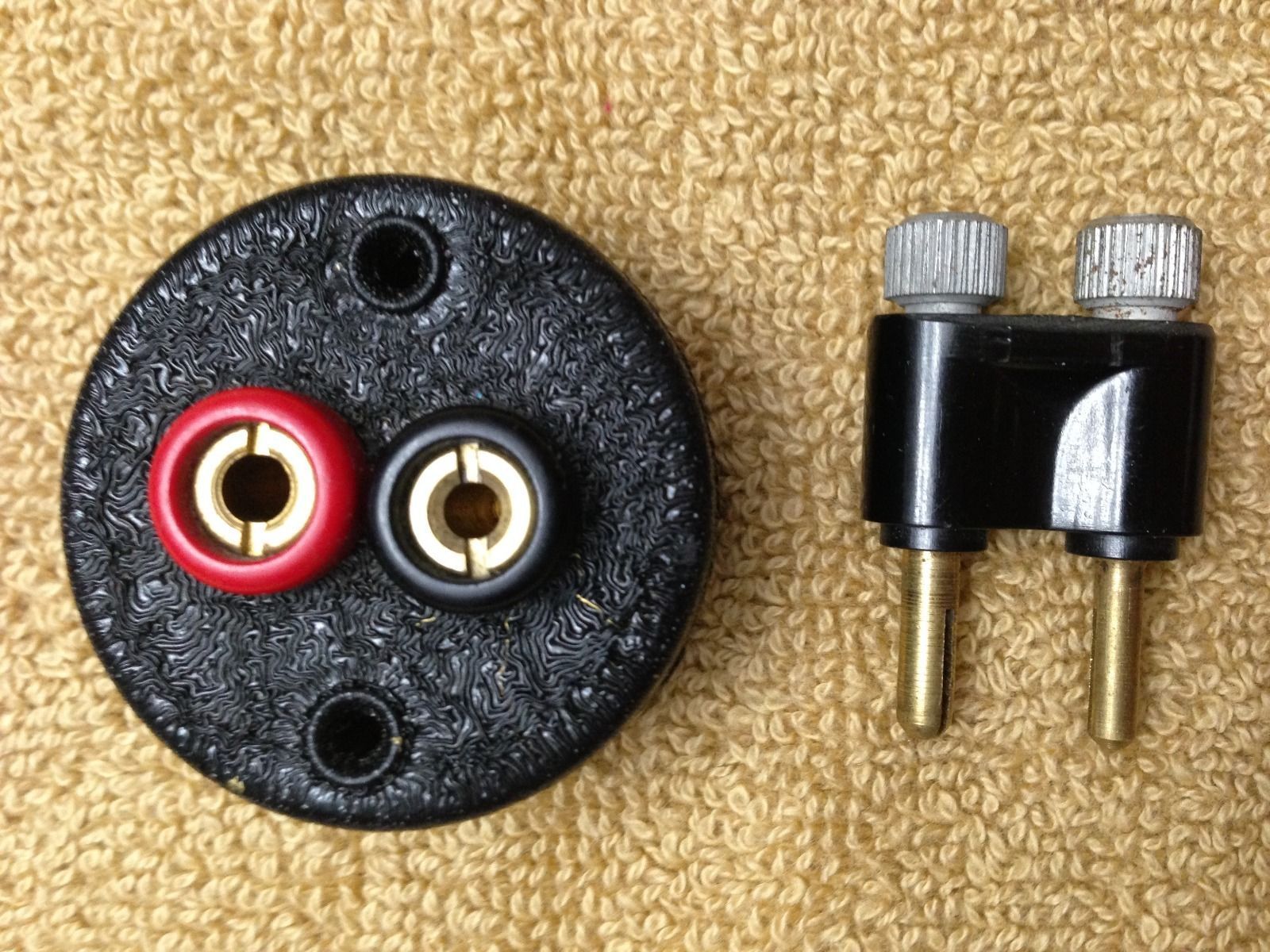

Please tell me how Lucas achieved this finish on the accessory socket? I've tried every wrinkle black on the market & they look nothing like that.

The 12 volt dash socket! Was it an option on the 3.8 S? I recognise the two pin plug and the individual sockets, but not the black disc with the clever paint job. Did Lucas make the disc or someone else? It is an unusual paint effect that close up seems different from the traditional 'crackle'. Something that most of us achieve through an (un)happy accident - such as not leaving the first coat long enough to dry. The plug and socket do seem much neater and more robust and reliable than the modern cigar lighter socket.

one time I accidentally got a similar wrinkled paint result because I painted a part after rubbing it with 80% alcohol and quickly spraying it with satin black when the temp was cold outside. It wrinkled a lot.

The 12V under-bonnet accessory socket/plug was fitted to many Jaguars & standard on the S Type. You could also buy a lead light to plug into it. It was mounted on the LHS inner arch ahead of the Regulator. On the 420 it was on the firewall etc.
Good place to plug in your battery maintenance charger.
It was made by Lucas.

You probably remember these on old Land Rover dashes.
