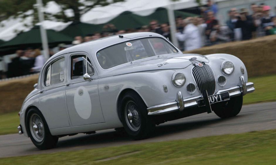

Coombs Racing Mk1 (Pearl Grey team car BUY 1 ~ one of their grey team Mk2's was BUY 12)

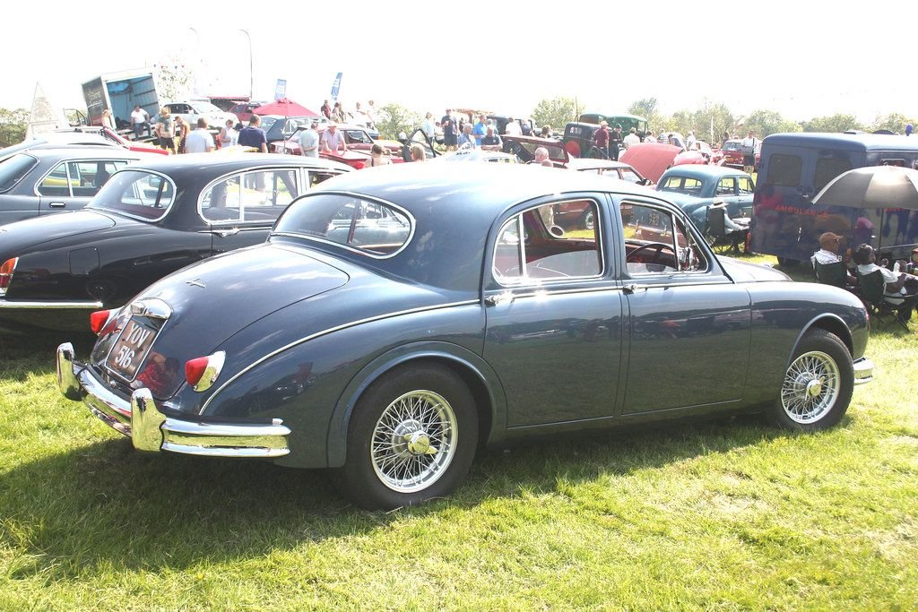

2.4 litre rear track for comparison (fitted with later spat):
A rather nice Mk1 with racing wires & wider rear axle:
