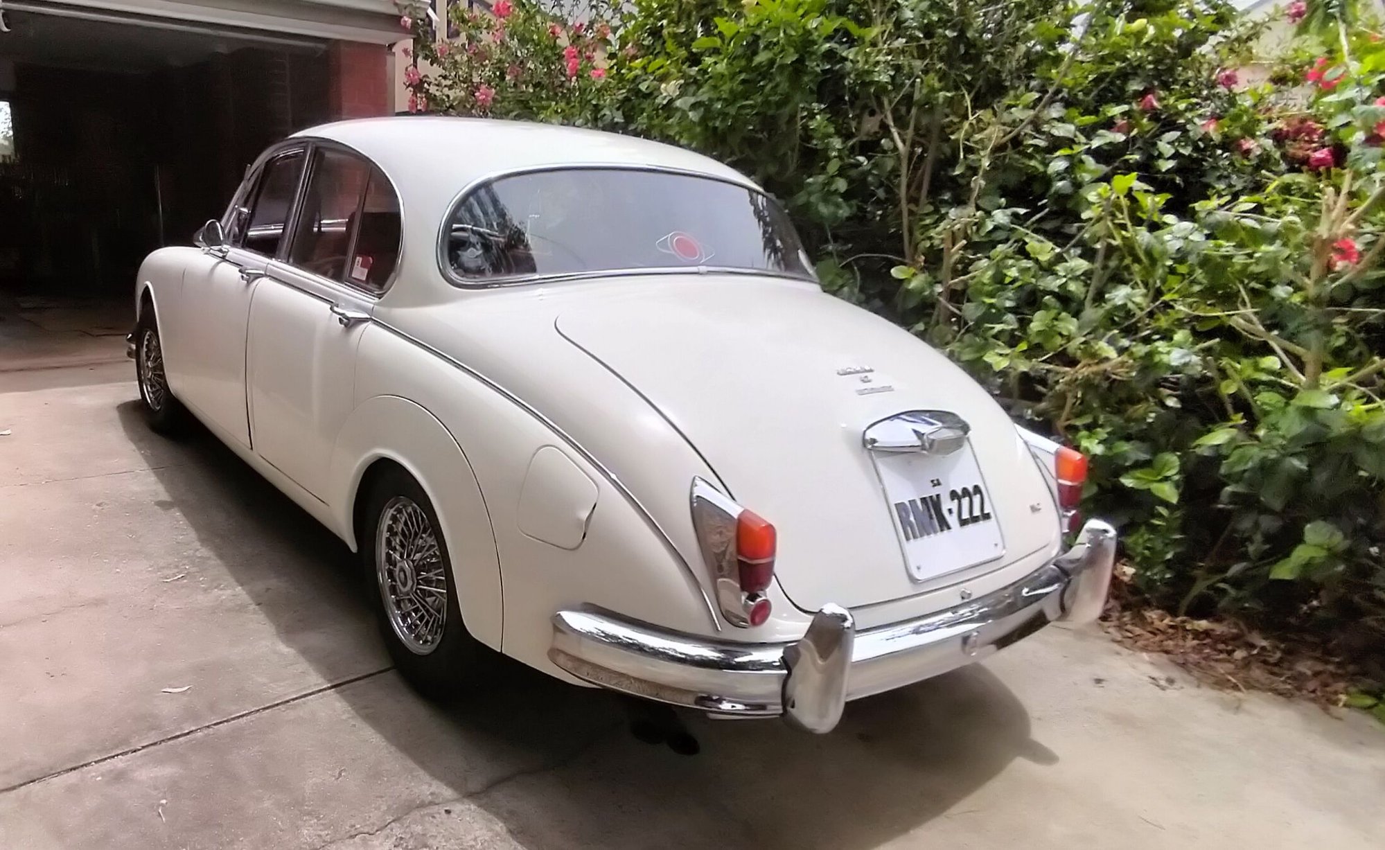

First serious venture out with no teething troubles - 40km in ever increasing circles from home. Against all odds (and some disbelief from some), my tuning has kinda worked!! Runs like a sewing machine. Car is still very slow/leisurely off the mark (need to work out why) but at 20mph it starts to really go. My homemade kickdown micro switch mechanism works - plant foot at 40mph and it takes off like a cut snake with an exhaust note that would dishearten an AMG driver!!!! It is extremely fast - hang on to steering wheel (and pray) kinda experience. Dunno why take off us so slow (any hints?). Woohoo

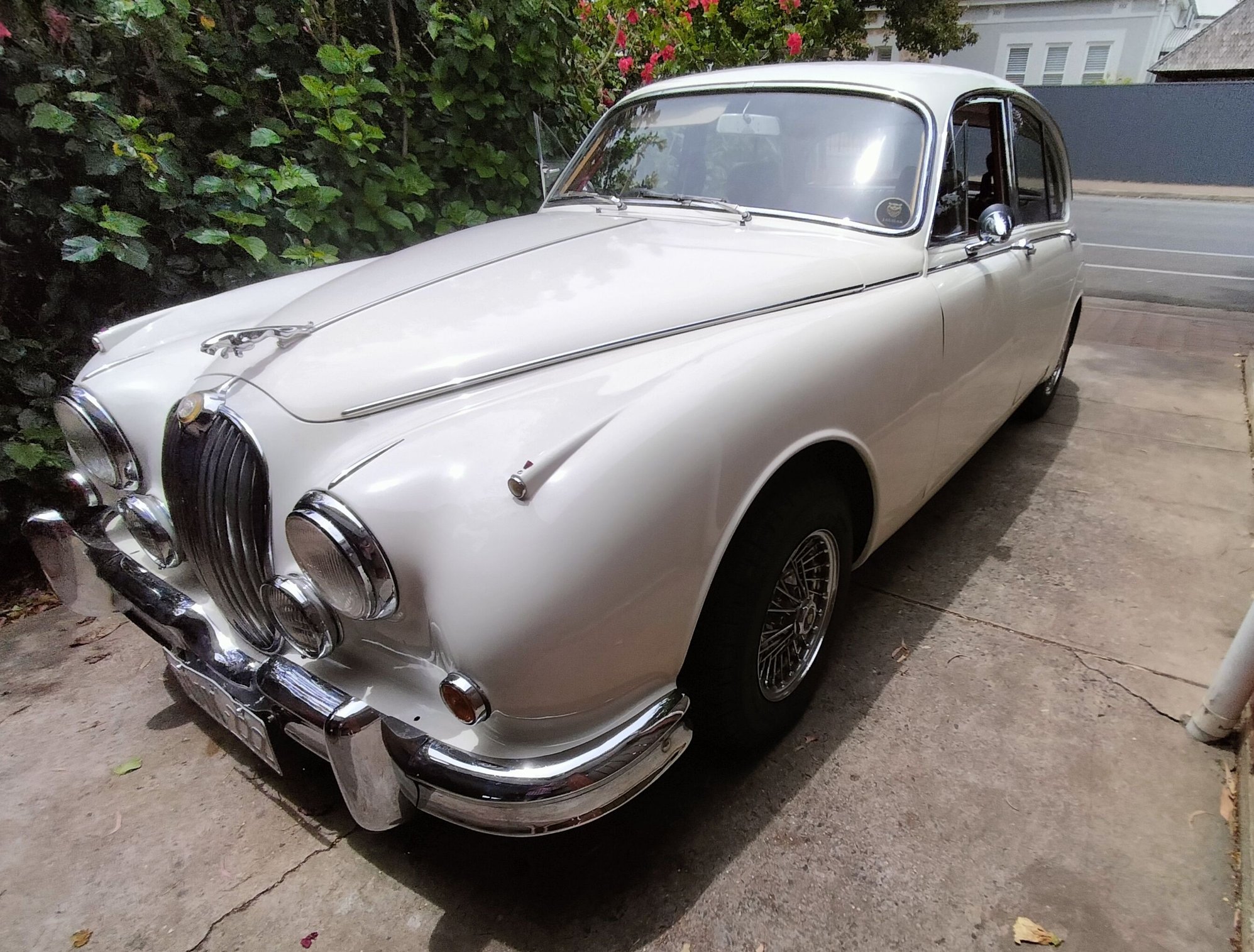

Did I mention that that's a very presentable car you've got there?
Very nice indeed.
