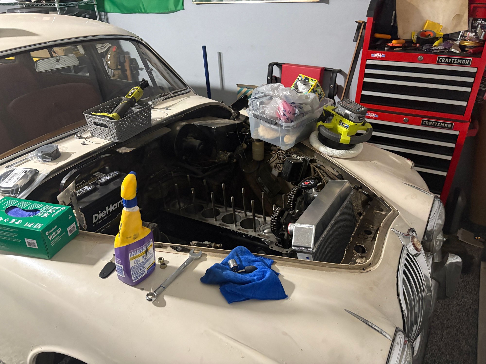

Is there a way to tell if the fuel pump is working?
should there be a noise when you turn the key?
atm my head and carbs are missing from the engine and as far as I know the tank is bone dry.
but i added a battery and tried the lights and radio… but not sure if the pump did anything.
tia
Peter

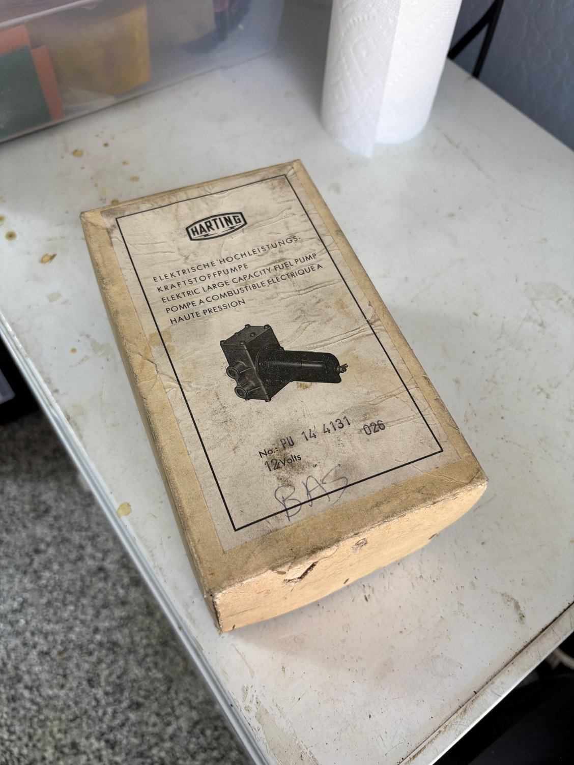

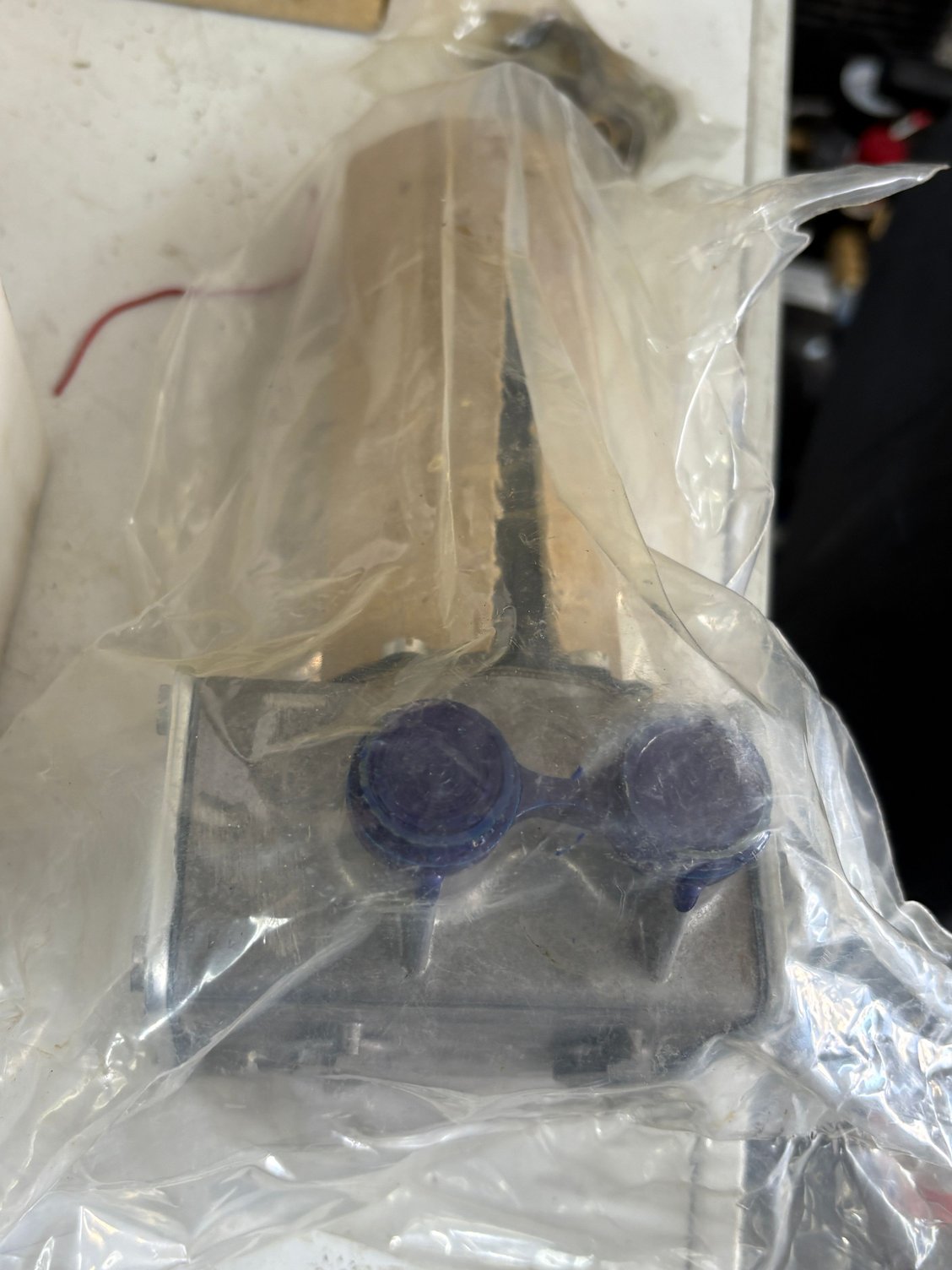

Just found this in the boxes of spares that came with it….

Just installed it and appart from having to replace a round terminal with a spade terminal - "Tadah!"
Works!
Now I just have to replace the Fuel Filter/Tank Plug and Gasket (it was seized in and removal with an impact driver tore the mesh cage (the worst stinking gas ever came out - same color as stewed tea) then flush the system out, I am assuming some gas mixed with seafoam will suffice?
