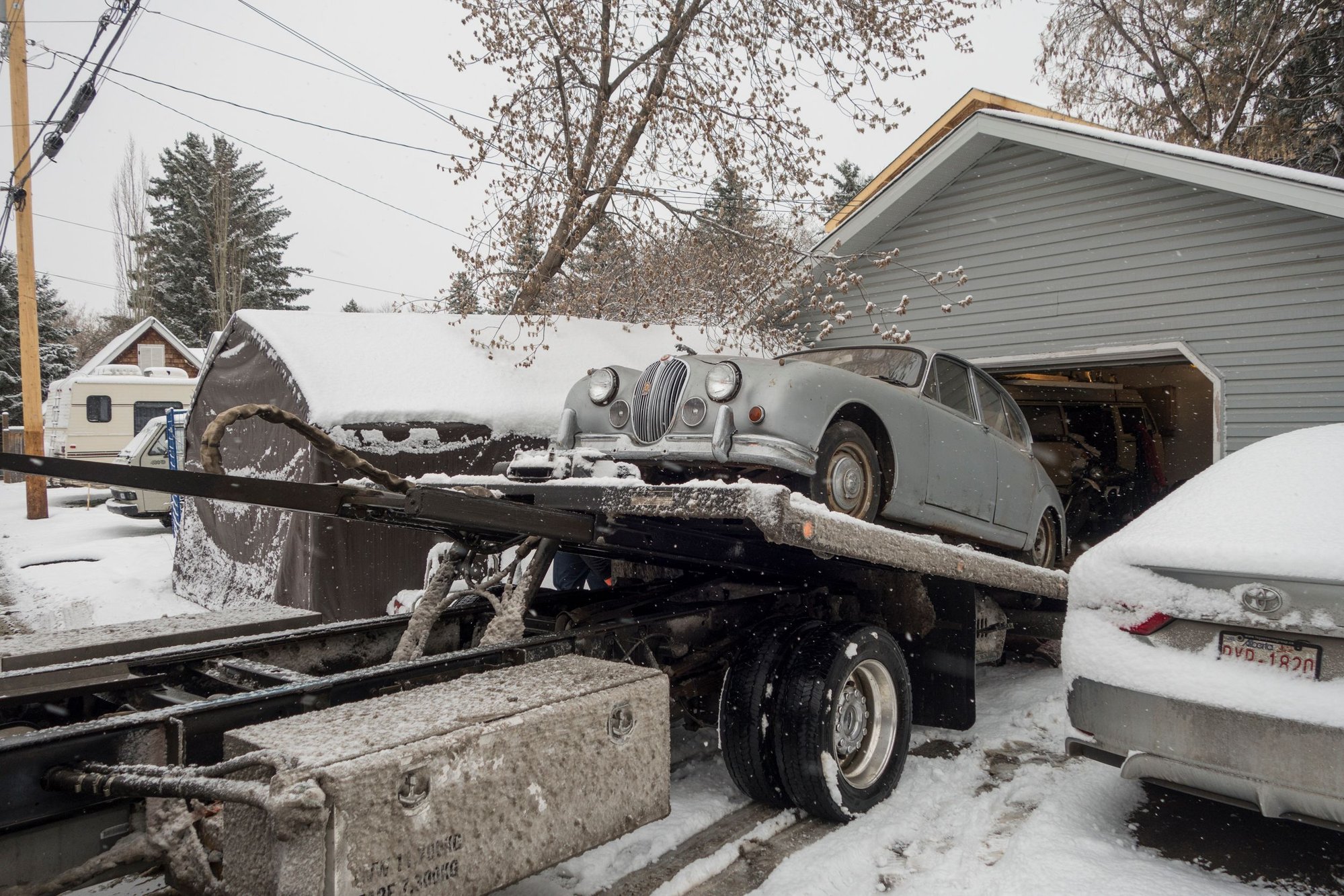

I have just acquired a 1965 Mk2 that had been sitting for many years. I hope to share my journey with you to getting another Mk2 back on the road.
Picking up the Mk2
Its new resting place

Are those photos recent, is it still snowing in Alberta !

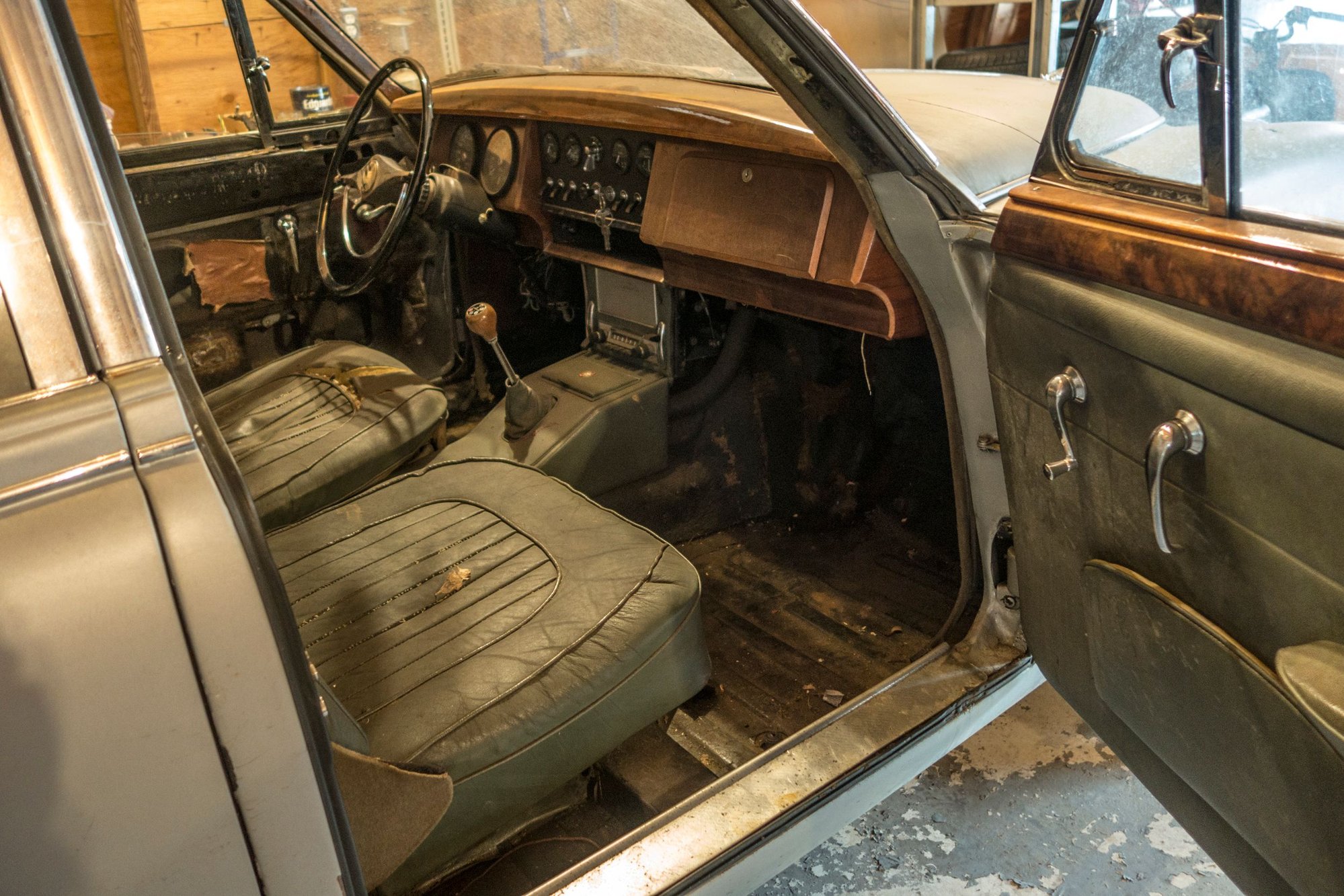

It stopped snowing about 3 weeks ago (last snow of the year was the day I brought the car home) and it is super nice here now (leaves mostly out on the trees). From my reading, as a LHD destined for North America the MK2 was not fitted with fog lights as they did not comply with local lighting regulations. I do however plan to install fog lights (I have a set but one is missing the back plate so will need some parts). The back of the car says it is a Mk2 and it is a 3.8 Litre, and per the chassis number it should have the limited slip differential. The interior is tired and I am missing some of the front kick panels and the drivers door card, so if anyone has some suede green interior pieces I would be interested. I am also missing the window chrome on both the front and rear wind screen. I have been able to get the motor to turn over and fire but can not get a sustained run so more tinkering to go (I have had the carbs apart once to clean out all the old petro and have managed to get decent spark to all the plugs).
Suede green interior

I had to laugh when I saw the first picture. I also brought my Mk2 project home on one of the worst days imaginable. I think the high was 10F that day. The hardest part was pushing the car into my garage from the flat bed. Four dudes and we could not get enough traction on the ice to get it over the lip into the garage.

We had the same problem, the brakes on the back are real tight and it took a sloping deck and three of us to get it off, then put on dollies to roll it in the corner...

Glad you found a good car, mine also has minimal rust, but it looks like it has had repairs in the past. My interior is missing all carpet and the front kick panels and the front driver door card - so there will be some money there. The motor seems to be in reasonable condition as compression is reasonable for sitting for many year but I am still cleaning out old gas from the fuel system and working on getting the carbs working properly. The previous owner to me had the car shipped from Nova Scotia and then it sat in his garage for 6 years... Once I get the motor running then I need to do the rest of the mechanicals such as all suspension bushings, ball joints and brakes.
