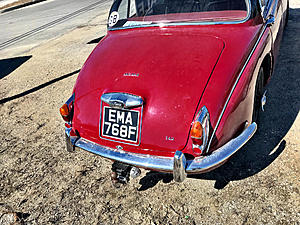

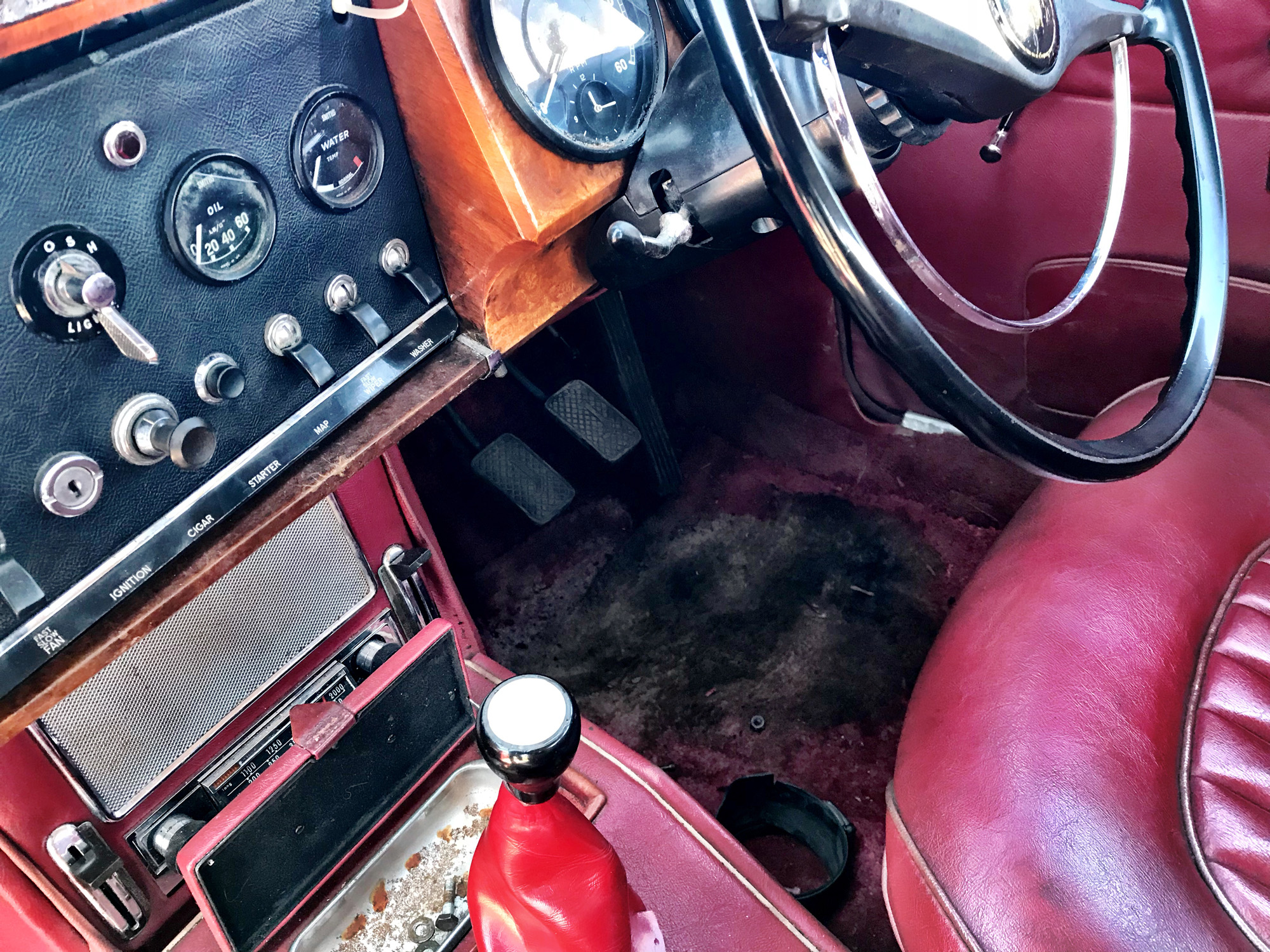

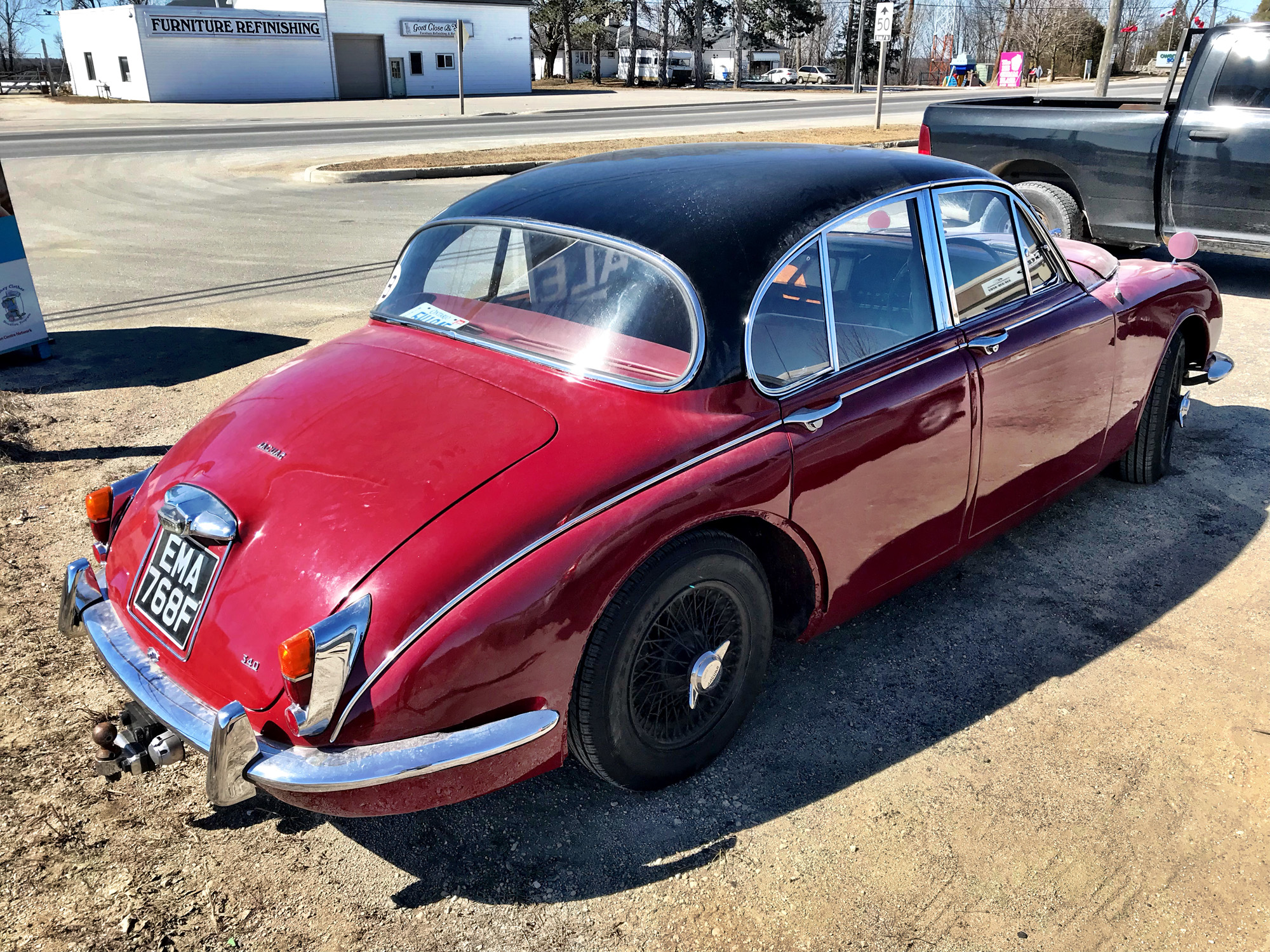

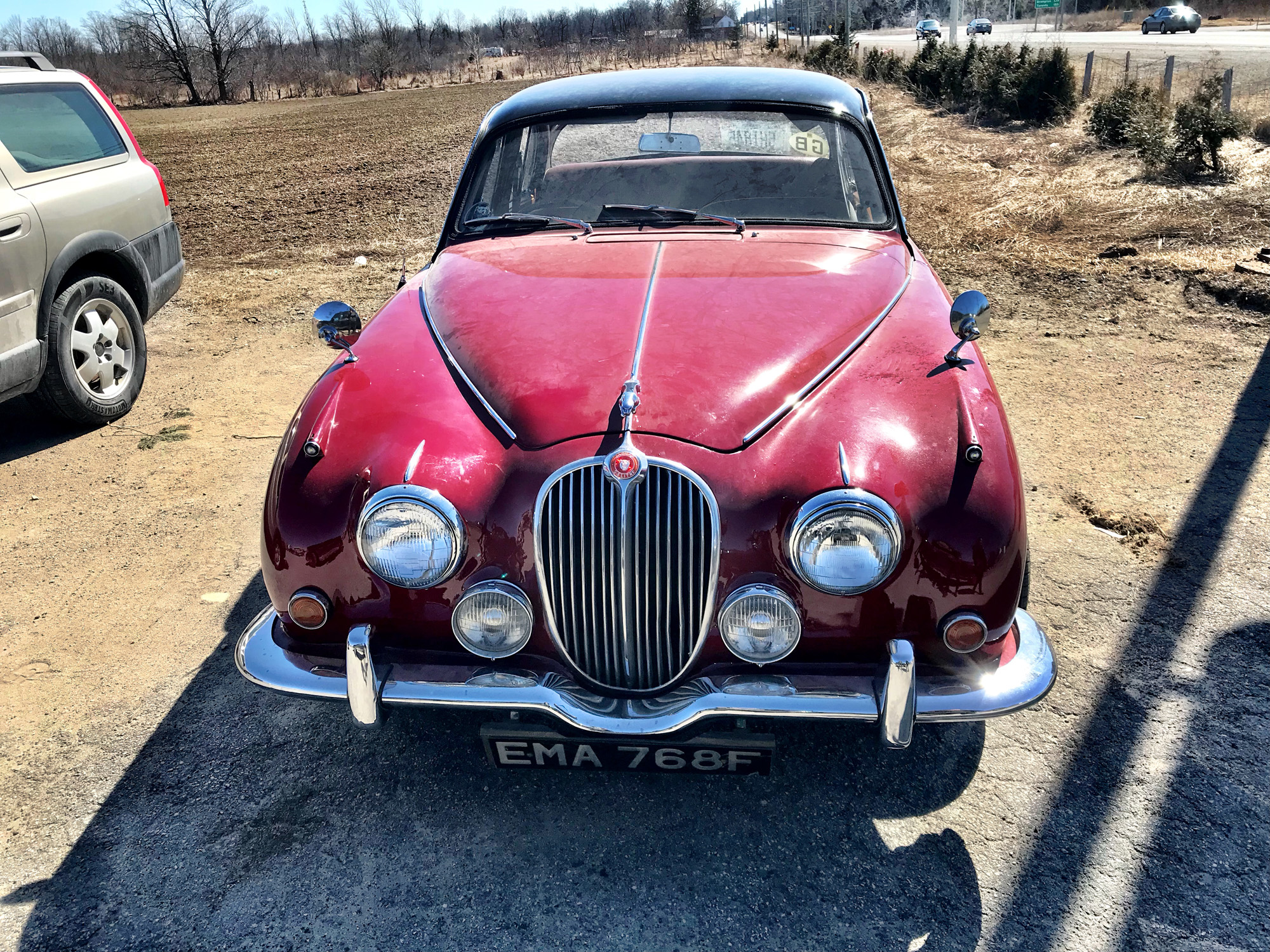

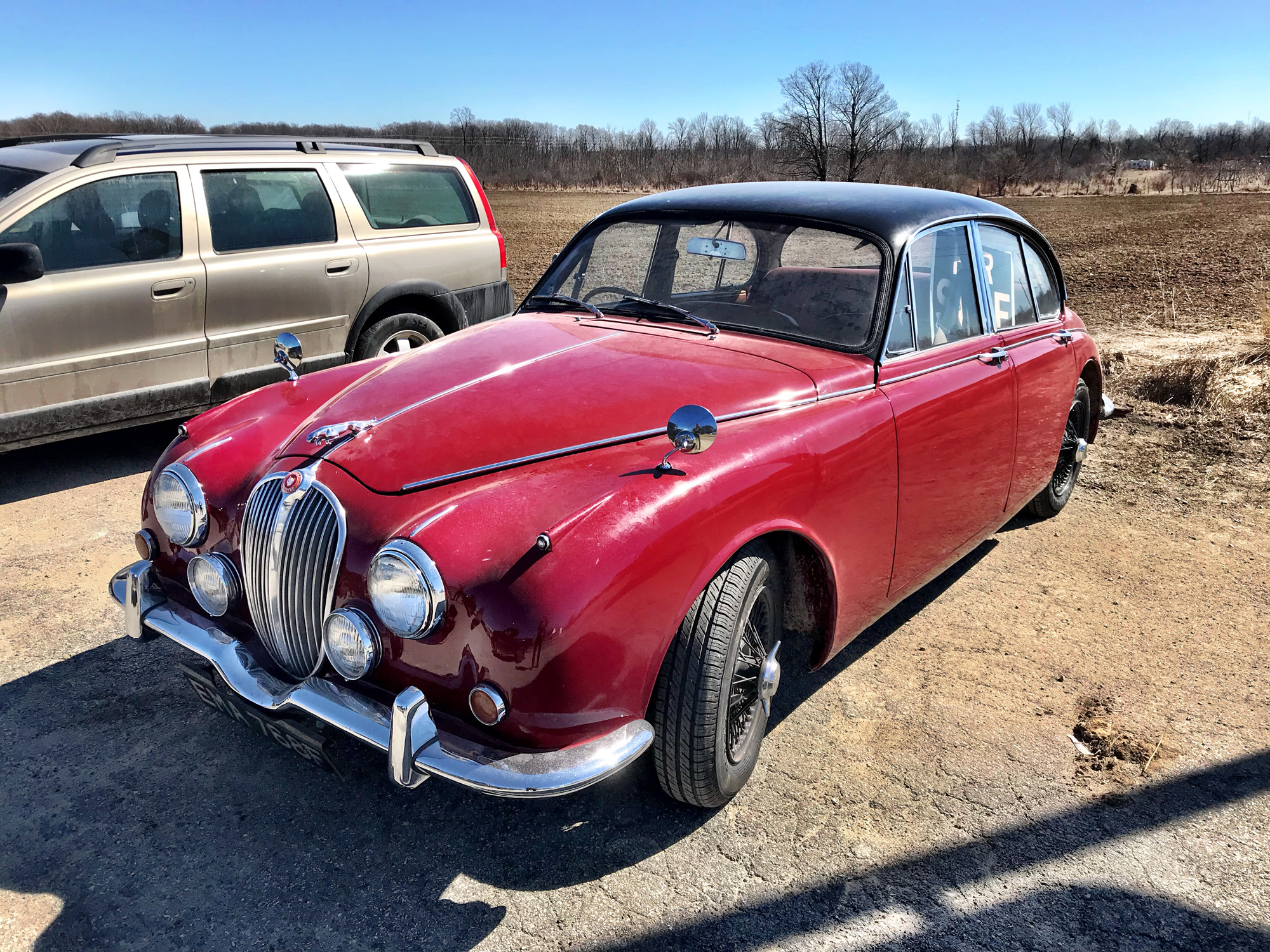

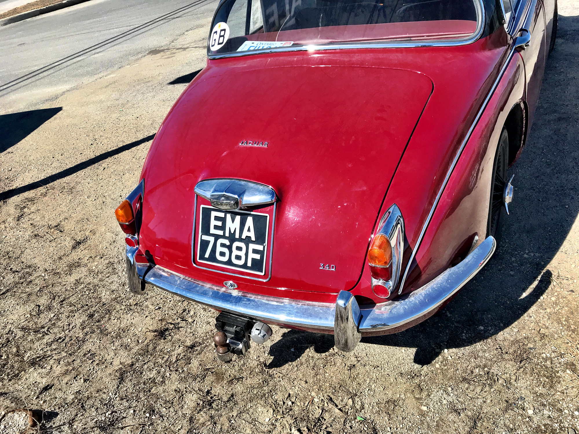

Hi everyone! I wanted to ask for some help. This is a car I spotted as I drove along the highway in Ontario and it made me slam on the brakes and check it out.
Of course it had a for sale sign on it I called on the car and the 'representative' said the owner had $20k CDN into it. It looks great on the outside and the interior looks pretty good (didn't take a close look). They may have the front window chrome trim and the rear fender skirts were in the back seats.
They said it runs well but that it needs a body mounted bracket repaired for the rear suspension and there are a few small holes in the floor area (I think he said).
It comes with a spare motor, transmission and wheels. He said it's a 1968 model with the correct 3.4L motor and it's a RHD manual with O/D (electric?).
I am pretty handy as I am always working on one of my VW Karmann Ghias. But, this would be new territory for me and it's scary. The car is beautiful though.
So, the bad news is I don't know much about classic Jaguars, but the good news is my wife loves that car too.
What should I check closely when I get to see the car again and what kind of money should he expect for this car?
I wish I took more photos, but I didn't know how obsessed I would become.
Thanks for your help.

Check oil pressure when up to temperature, it should hold well about 40 lbs.
Check for even door gaps if they are tight at the top and open lower down, it can be a sign that the car has sagged from rust at some point, check the inside of front wheel arches for repairs, check for body filler at lower part of A post and B-C post, check front cross member, front chassis legs and crows feet for rust.
Lift the carpet and check for rust in the floor especially by the pedals and the same area on the passenger side, and also under the rear seat, also check for rust around the rear spring boxes and panhard rod fixing point.

It's an Ontario car and the pan hard rod area needs work, look for extensive rust in that area as well as the spring pockets.
If you are able, remove the back seat and look for rust bubbles right where the spring pockets run underneath _ the rear seat just lifts out.
The fender skirts missing are also an indication of rust in the body.
Bring a magnet along.

It's got the black roof on it like the Morse car. I've often wondered about that roof, was it a factory option or something people did aftermarket...

The roof shouldn't be black, as someone else mentioned this has probably been done to emulate Inspector Morse's car (although that one of course had a vinyl roof rather than painted).
Looks ok in the pictures but the rear arch areas where the spats would go look like they may be sculptures in filler, it could just be the photo though.
The interior will probably be good because its ambla (plastic) rather than leather.
I hadn't even noticed it wasn't vinyl in these pictures! Not sure about just painting it, looks a bit wrong.
My question still stands though, was the vinyl roof a factory option?

The black roof, over a contrasting colour ( or a black vinyl roof) was never a factory option.
