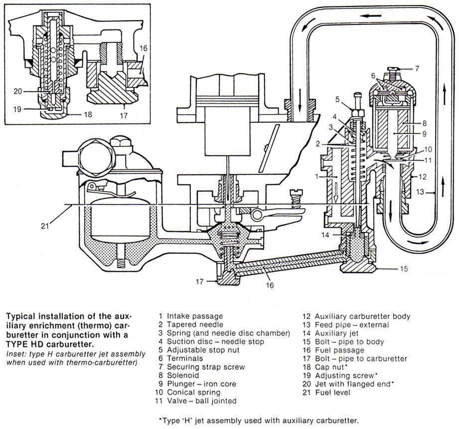

I have not done this myself but you need to replace item 58 (Jet Housing Assembly) in this diagram in both HD6 thermo carbs so you can manually pull down the jets on their diaphragms with one of these from Burlen. (AUC 8654)
AUC 8654
Then you can fit a slider from a Mk2 with Solex carbs, A Bowden cable & the necessary inner and outer cable clamps on the carbs similar to E Type.

Well as shown in the HD6 Thermo diagram above it would appear so. That's where I got the number from unless it's an error or merely indicates that it is normally associated with HD8's. As mentioned by MK2 above the Healey 3000's used manual chokes with HD6's.
I guess to make sure one should contact Burlen. As I say I've never done this. As long as Part number 58 in the diagram is still available this should be doable. One should check that Part 58 is in fact AUC 8654 as it was when I first checked.

As many do. They delete the Otter switch in the manifold and switch the AED manually. Mine works fine as originally designed & I always keep a spare Otter switch. Many have starting issues because they don't set up the needle in the AED for their ambient conditions (i.e. adequate enrichment.)
No 2 in diagram.
