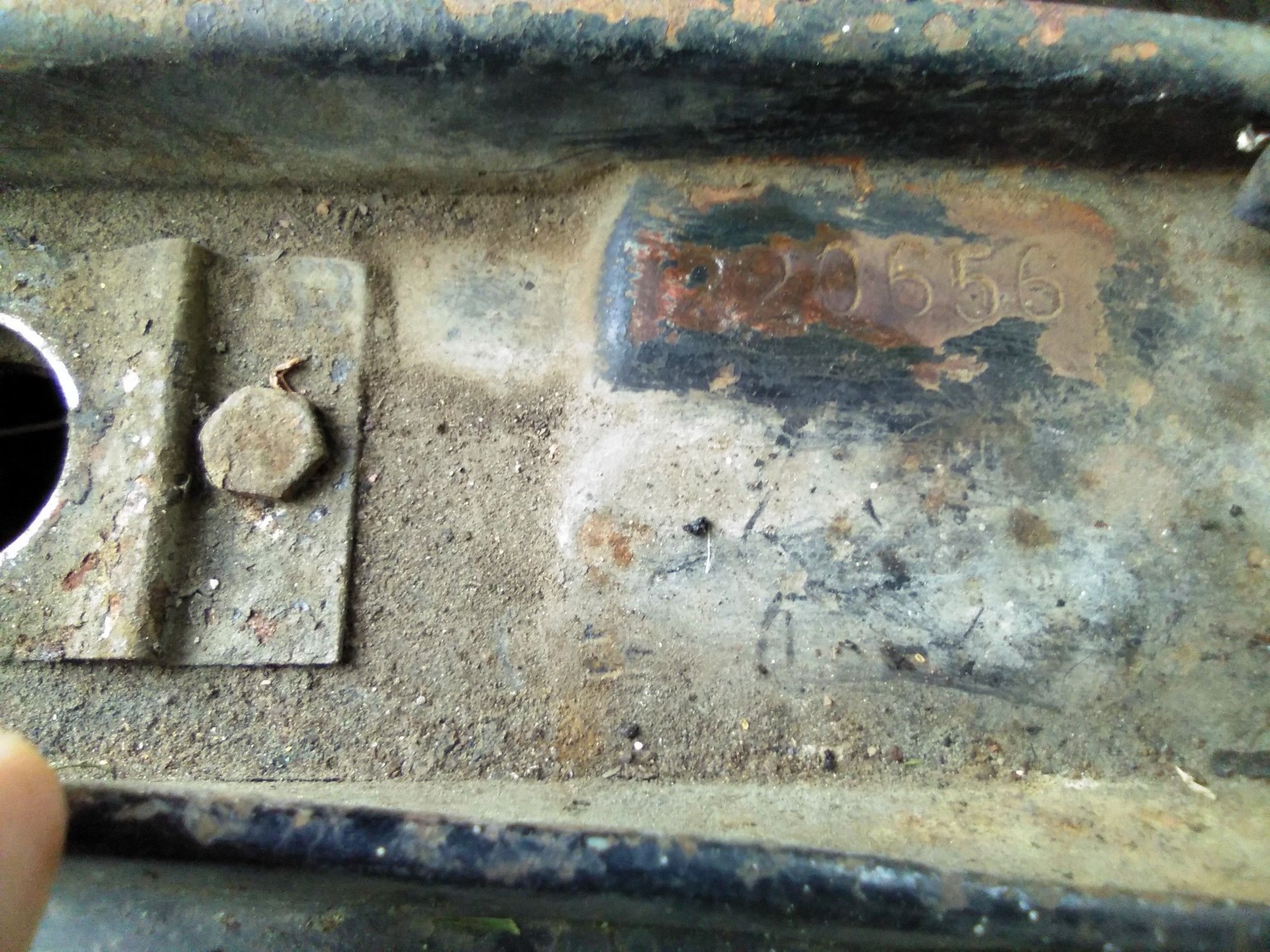

Default Ah Ha! Found it on the car in my driveway
Ah Ha! I have indeed been able to locate this chassis number stamping next to the receiver for the bonnet latch
Took this photo after dark with a flashlight so not the best lighting.

The seller of this parts car sent me the following low res photo
He thought this said Z3656 but since that is not a proper MKII chassis number I am betting there is another number there and that the "Z" is actually a 2
Here is a similar photo of the same area on my $900 1962 car I have here in my driveway.
This is chassis number 220656
Does anyone else want to guess about what the actual chassis number is on this parts car?

I have played with the photo changing the resolution and colour but the number does not pop out. You will have to get the seller to give it, as suggested, a rub with some wire wool or emery paper and the number will show. At least you know the number is there and if you have the number you can get a title on it.
