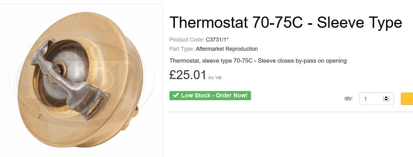

Ensure that you use the shrouded thermostat that blocks off the bypass port so that all coolant goes via the radiator hot. There is an error in the parts manual. Picture correct. P/N wrong. Correct P/N C3731/1* ~ Barratts make these thermostats themselves in their large workshop. They work excellently. No need to have Thermostat housing machined.

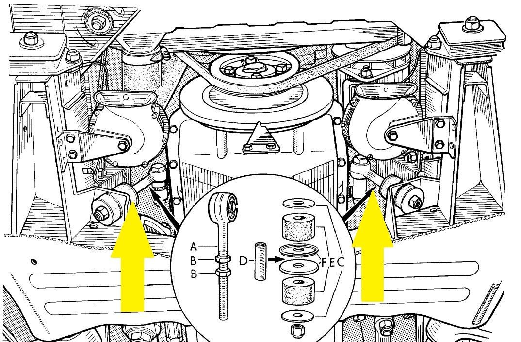

The radiator should not take more than an hour to remove but it depends on if you know what you are doing. You do need a small pair of hands to get to the nuts and bolts and the patience of a saint.
Top and bottom hoses need to be removed and the radiator drained. On my car because it is a BW35 Auto box I have a gearbox oil cooler in the base of the radiator and these hoses x2 have to be removed.
The fan shroud if fitted needs to be removed from the back of the radiator. There are four small (7/16) nuts on studs that hold the shroud to the radiator. Once removed the shroud then hangs on the fan as you cannot get the shroud between the fan blades and the back of the radiator. This also means the shroud cannot be removed whilst still attached to the radiator.
The radiator is held on to the car with four bolts (1/2) down the back of the radiator where the shroud sits. Once removed the radiator can be lifted vertically out of the car. On my car the bottom of the radiator has two spikes that sit in two rubber grommets and you have to wiggle the radiator from side to side to release the spikes.
As a tip I normally slide a piece of cardboard down the back of the radiator between it and the fan blades so when lifting the radiator up or lowering it down the fan blades do not damage the fins on the back of the radiator.
When refitting don't forget the shroud needs to be hung over the fan before the radiator is lowered into position.
With the radiator out of the car it is a good time to clean behind the grill or even remove the front grill for polishing as you have easy access to the nuts.
With the radiator out of the way it is also a good time to stick a powerful hose in the engine block and flush out the coolant system. Remove the thermostat so the water jet can circulate right around the water ways. Also flush out the heater Matrix radiator. You will be surprised at how much muck and rusty water comes out of the system.

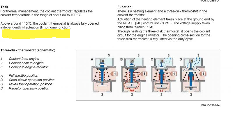

Thoughts have changed on this matter over time. Today people run cars a lot hotter than before for efficiency. VW, as an example would like to run at a bulk oil temperature of 127 deg C. (Coolant still below boiling)
Mercedes designed their 4 way thermostat to run engines at more optimal temperature for their designs and variable/varying conditions.
Modern thinking is running hotter. Why Jaguar chose approx 70 degrees who knows? (70 to 75 thermostat)
Barratts can drown you in thermostats that operate at 82 deg C & 88 deg C. They just wont have the sleeve.
Merc 4 way example. ~ heated by an element, monitored & controlled by the ECU.
