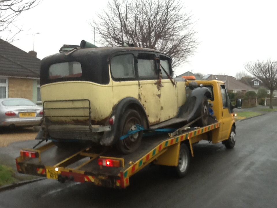

Default Thanks for the advice and update on my recent acquisition
Thank you all for your help I have taken the advice about getting leather food into the seats prior to attempting to re-colour and as the leather is coming back to life the colour appears to also be coming back with a rich patina which reflects the years, I shall post some before and after shots when task complete. And as if I didn't have enough to do I have just added to my collection a 1932 daimler LQ3 limousine 7 seater with glass partition, serious amount of work needed but I am struggling to find much knowledge or documentation handbooks etc on her. If anyone out there can help in any way whatsoever I would really appreciate it. Photo of the newly arrived below.
Thanks
Den

wow, that is an awesome vehicle. Congratulations on rescuing it.
I would start by getting the VIN and writing to the Jaguar Daimler Heritage Trust, click on the link below:
Jaguar Heritage

ThNks Jose, yes very pleased so far so good, apart from my ignorance on vintage all looks good, won't need to go the gym though, everything is mega heavy and solid as granite.
Have just posted jaguar heritage trust as you suggest, thanks

yes can't wait to get on with the limo, just doing a bit of cleaning and oiling at the moment while I get more data and confidence, can't afford to make any mistakes spares are probably a tad rare.

Den, I wonder if Daimler & Lanchester Owners' Club can be of any help with your new acquisition.

Thank you Greg yes have just been advised of them by another member, wii MSG them and fingers crossed.
