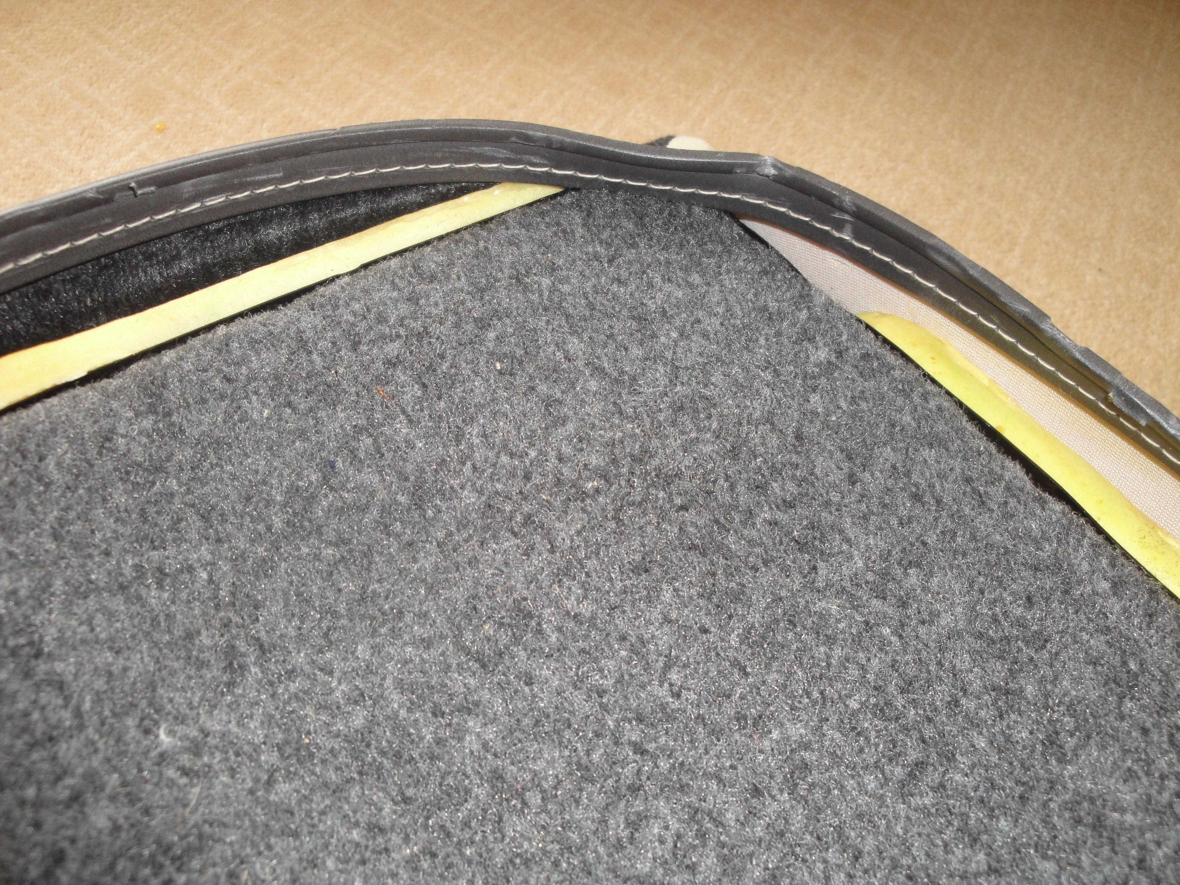

I too had this problem when I fitted rear seat heaters. (Most popular mod I've done!)
It's a bit brutal, but the grey felt stays put and the seat cover has to be levered up and away from it and over the edge of the seat squab. I seem to remember using a broad bladed screwdriver in the end as the only tool I had that was strong enough to get the first section lifted. The first corner is the hardest part. Difficult not to cause a little bit of damage, but if it's at the bottom edge, it won't be seen. It's good fun putting it back too!
Hope the photo helps!

OK. I guess here goes! Thanks for the tip, and the photo. I have a variety of removal tools, hopefully I can get a corner to cooperate.
Thanks so much.

Had to wait to have enough time to take out seats and pull off the leather. Your tip worked great! Other than some sore fingers, I have the pads on and am putting things back. Did you find a good place to electrically tap into in the back, or did you run the power line to the front? I have a good place for ground right in the back.
