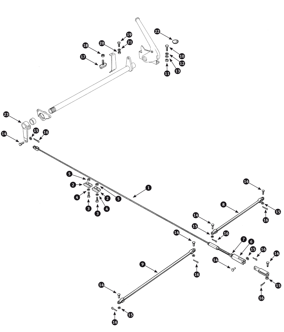

I need the two clevis fork pieces that attach the rear end of the hand brake cable to the pivot arm on the differential case on my Mark 2. These are items 8 and 10 in the shop manual illustration of the hand brake system.
Anyone have a good used set you'd be willing to part with?

I am not using the all stock pieces, let me look and see what your talking about. Use this illustration, anything on the diff/rear end I will not be using.

I'm looking for the part labeled #6, plus the clevis/forked part it attaches to, which is not numbered in the figure.

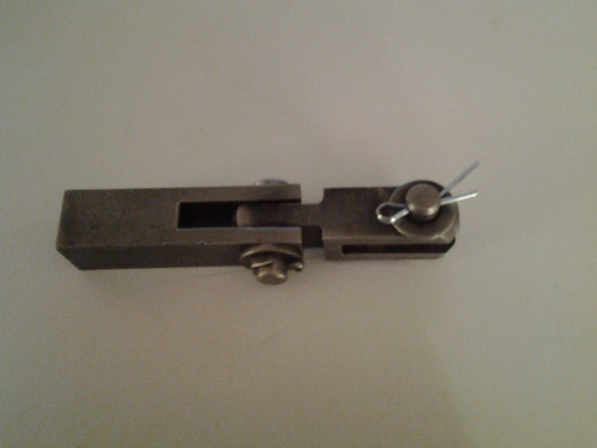

I have it off, just need an address....

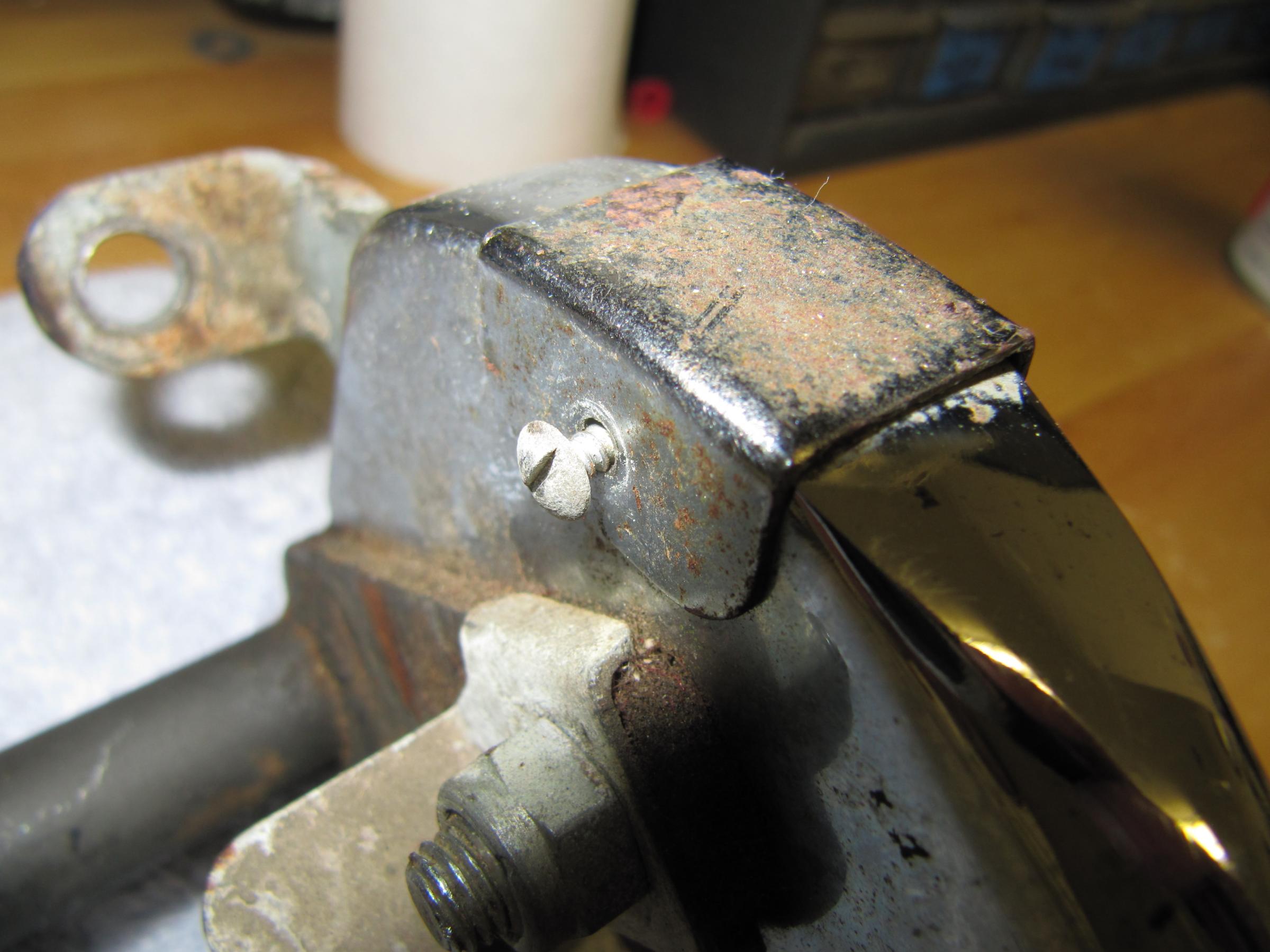

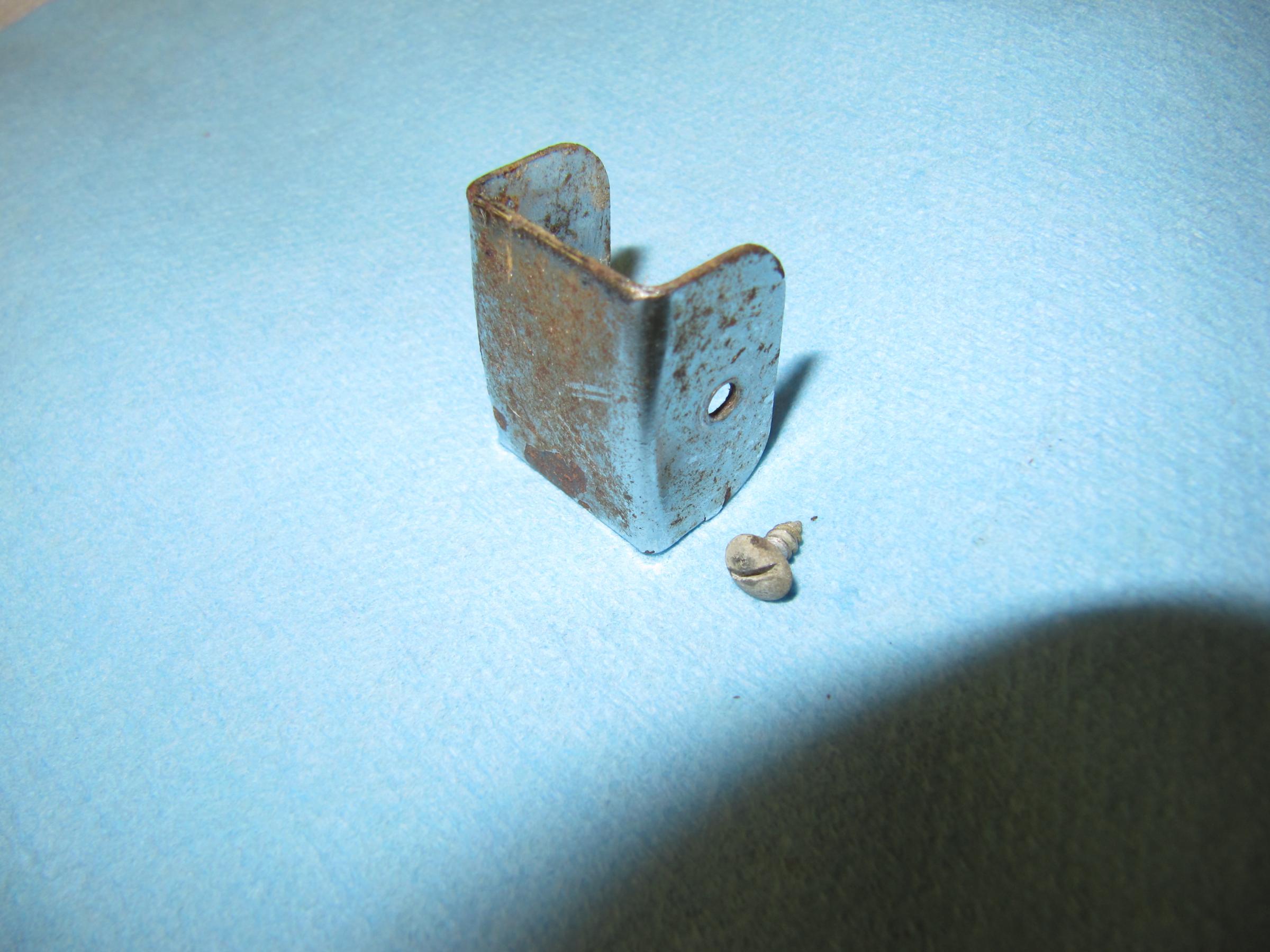

I am looking for the little piece shown in the images below. I could get this little piece rechromed but it would cost much more than the part is worth. Do you happen to have a good rust free example?

Part is in the mail this pm, dmericas
