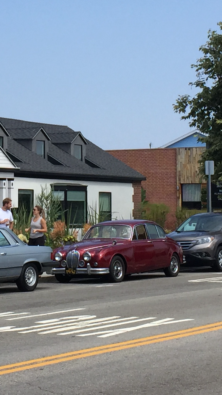

I didn't get anything custom made, there's an ACE locally that has an amazing fasteners section. There was a tray of stainless spacers that are thick stainless with 1/2 inch holes in the middle. i got a handful of 3/8 inch tall ones and put them around the bolts in between the pan and the arm.
This is a terrible quality picture but it's all I have right now of the car at ride height.
