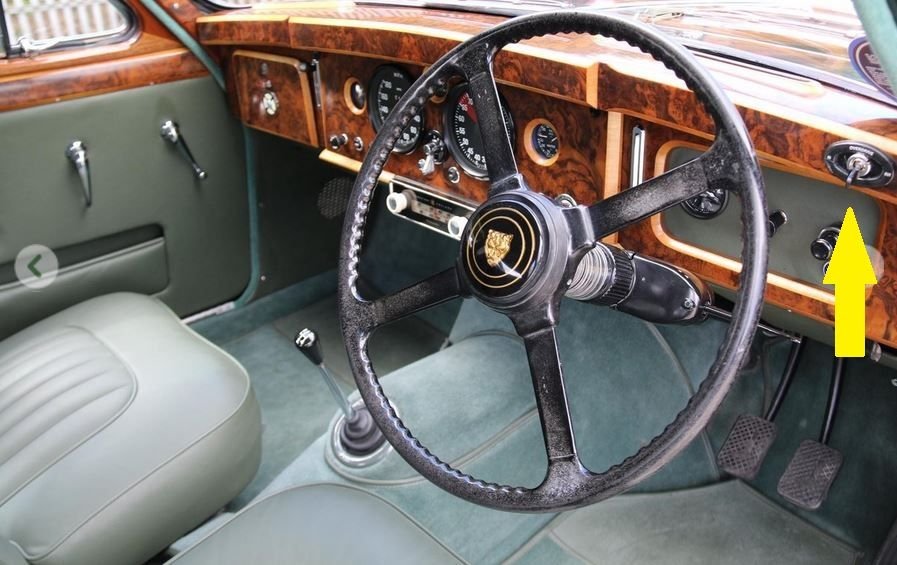

At some point fairly early on in Mark 2 production, there was a swap to the later more compact overdrive unit. If the one on the 3.4 is the later type, you may need the later propshaft. Don't forget to check the wiring loom to see if the overdrive wiring in it. I'm not sure where the OD switch was located on the Mk1. On the Mk2 it was on the binnacle.

I just did that conversion on my mk1-56. As the early 2,4 has the gear-lever in a more forward position than later cars and I wanted original looks I installed a moss box with od from a mk2. The top cover on the remote lever box from the mk2 was exchanged with the original mk1 box top cover. Very easily done. Gearbox mount is the same and the prop shaft from the mk2 was used. The od switch is situated in the corner of the upper wooden facia rail. You need to drill through the panel if you want it there, I did on mine. All in all an easy installation and what a difference it does to the car! Good luck!

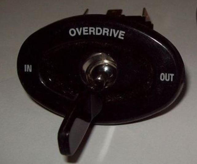

There are Mods to this car:
Unmolested.
Manufactured by Trico. Looks a bit odd because the escutcheon is just leaning against the switch with the retaining bezel behind instead of in front.

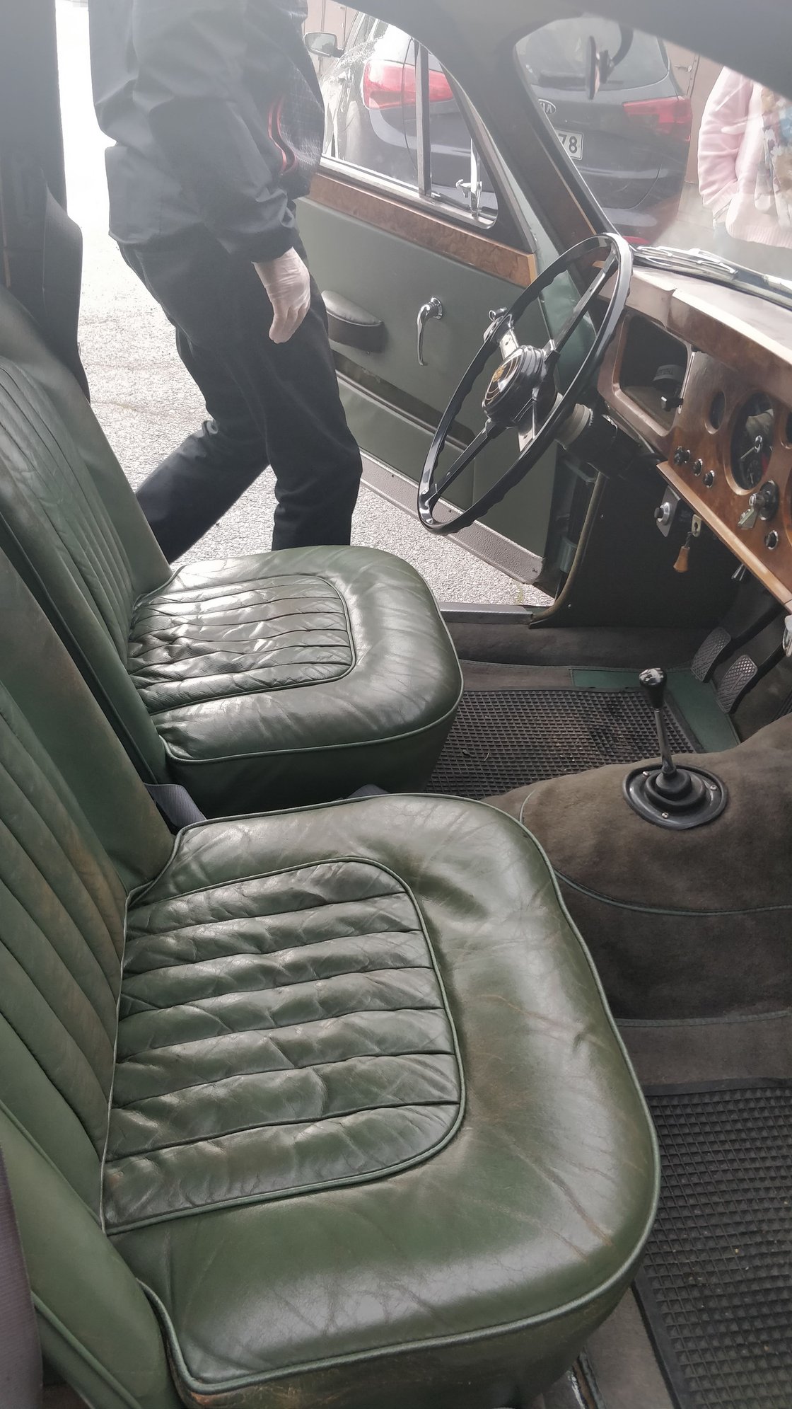

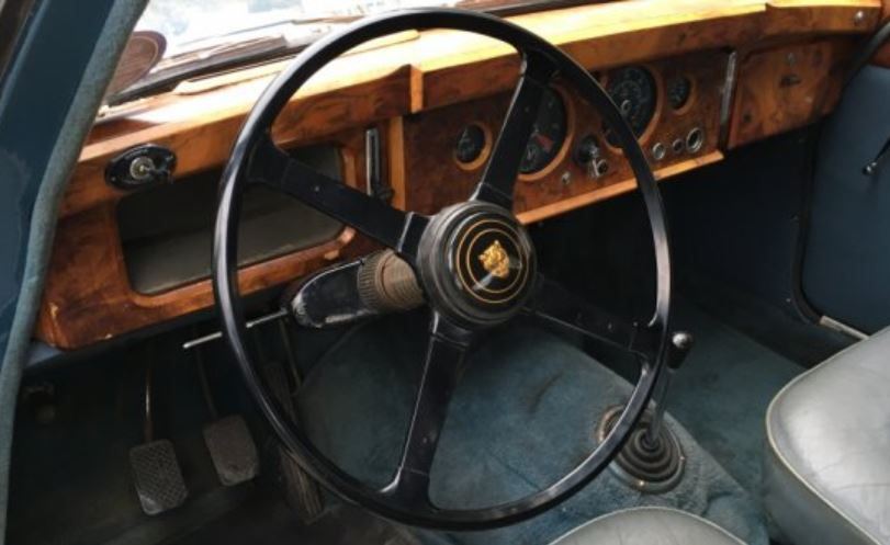

Early type of mk1 gear lever and top cover.
Late type of mk1 lever and top cover.

You right the gear lever is far from the seats. Nice upgrade you did👍👍
