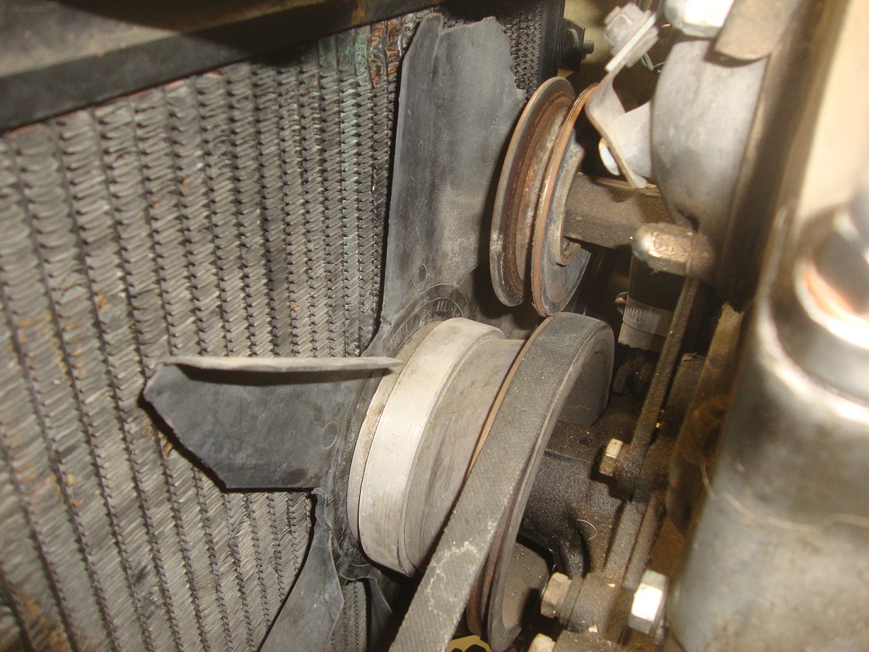

Lin,
Here's a link to some pics I snapped of mine for you. This is the one mentioned on the archaic site. Note how chipped and cracked it is, hence the replacement 15" I purchased. This fan needs about an inch cut from the depth of the blades to clear the AC belt tensioner. The 16" also hit something in my engine. The plastic material absolutely did not like being sheared so I will use a saw this time for a better result.
Flex-a-lite 415 Fan Photos by GT6Steve | Photobucket

Primaz,
I do agree that it would be a far better proposition. I use a flex-a-lite nylon fan on my 3.8l, and so far it has proved to be lighter by far and seems to move more air than the original 12 blades. However, a puller fan would certainly eliminate the problems of excessive temperature in traffic, which the nylon fan improves but does not resolve with the aircon on. I do use a pusher fan, but it has proved relatively ineffective in city traffic.
The main issue I see in using a puller electric fan is that I have a bit more than 3" clearance between the water pump and the radiator and that would prevent me to put a 15 or 16" puller fan which needs about 4.5" to clear the water pump if it is centered. A smaller, off center fan (12"?) would work, but would it be enough? I think I see on your picture that this is the route you took. What's your experience? Is that enough to keep the right temperature stable in traffic by 90 deg. Florida summers?
