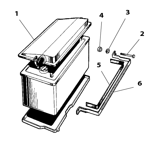

here's a picture of the bolts and a drawing of the parts involved. Item No. 3 is the spiral washer.
I have no clue what item No. 4 is, if it is the Nut for the bolt, in my S type the nuts are imbedded / welded in the bulkhead / firewall.

Yes that is puzzling because mine are the same as you describe and I was glad I did not need to hold the nut while installing the bolt. That would be very hard!

Ah got it, it's whats called a Thackery washer, you should be able to order them online easily, it will be 1/4", used to allow a flexible joint.
These are used on the throttle linkage quite a bit as well as other places on the Jags
