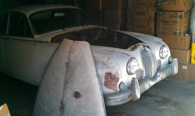

hi all my name is Trevor I have a 62 mkii that I inherited from a relative its been sitting in a field for 25+ yrs the engine was removed and is no longer useable I am going to do an engine swap in it over to a chevy lt1 out of a mid 90s camaro due to cost. I want something uniqe and I can drive I don't have alot of money and will be doing this pretty much on my own and will take a long time to do(wife and kids). I am trying to find out if these cars are 12v or 6v systems first off and i've heard the wiring is weird so any help on that would be appreciated. I know that one of my uncles had changed the front end out to a splined wire wheel set up but I want to go back to 5 lug if thats possible because that is what the rear end is and I was thinking of maybe changing it to right hand drive because I heard that isn't to hard to do either( like I said something unique) any and all input is appreciated. just dying to get started on it probably mostly body work because I can do that myself for cheap

Hi, Trevor. Welcome. I just started working on my son's '61 MK2 3.8 which spent a lot of years in a barn. I'm documenting progress on the "1961 MK2 3.8 Project" thread here. I haven't started the car yet. Cleaning out the gas tank and lines at the moment. First thing I did was replace the battery, so I can tell you with certainty that it's a 12v, Positive Ground system. I wouldn't know what you have to do to set up an engine from a negative ground system, but replacing Jag engines is very popular, though I would never do it. Someone here will know. There are several threads on resto-moding MK2s. Also the Service Manual and Parts book you can download here in PDF form are an excellent help and the illustrations well done. For little money and lots of labor, body work is good, and you can stop when you need to change a kid's diaper, if necessary.

Welcome to the forum, pretty new myself, I have been given some good direction from some of the guys on the site. My 66 Mk2 has been converted to negative earth, google 'how to change Jaguar Mk2 to negative earth' it's pretty easy worst part is the Dynamo, but you will have a negative earth alternator on the donor engine so this is not applicable, you will also be better off with a voltmeter in place of the ammeter with an alternator, easy to source as the smiths units are used on most British cars of that age. Electrics are pretty simple with only 2 fuses in the fuse box, so it may be worth looking at the fuse box from your engine donor car or an aftermarket unit.
The front splined hubs can be removed and stud hubs fitted, I'm not sure if any of the later cars will fit, eg 420, S type, so ask the guys the question.
I also fitted twin pot brake callipers from the S type to the front, the original single pot were bloody scary. if you post your email address I'll send you a soft copy of the manual, or you can google Jaguar MK2 service manual, quite comprehensive, but a Haynes manual (ebay) gives more detail.
I've also seen on the web somewhere quite a detailed site where someone has installed an american V8 in a MK2. Get googling, loads of info out there.
