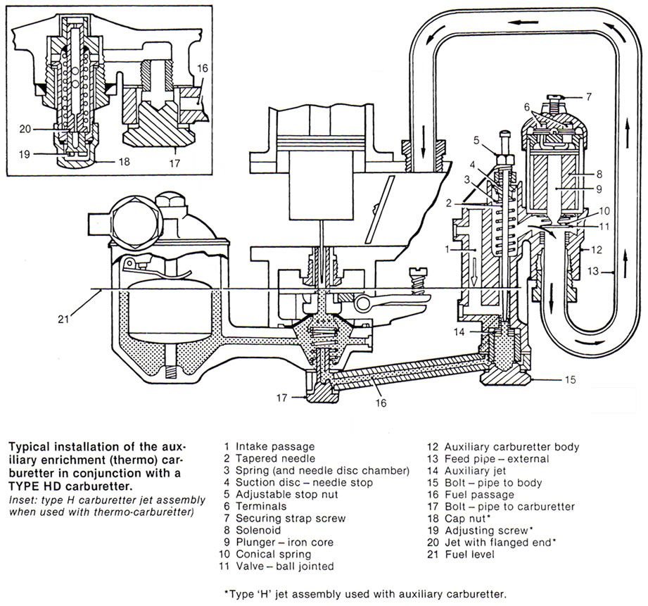

I will throw in my ten pennies worth and suggest it might be float height related.
The float height as mentioned has a specific height which controls not just when the fuel is allowed to flow into the float chamber but also the height at which the fuel sits in the chamber. The fuel height in the chamber is also reflected in the bottom of the needle valve seat below the butterfly. If the float chamber fuel level is high then fuel can over flow the needle valve seat causing the carbs to run rich but it can also cause over run which is what I was suffering from. Even though I turned the ignition off and therefore the fuel pumps where no longer pushing fuel into the float chamber because my float height was too high a certain amount of fuel was still rising out of the needle valve seat causing the run on. Once the fuel had burnt off and the level in the float chamber had dropped the engine would die.
Taking this scenario into your problem there is a likelihood that if your float height is such to allow more fuel to seep through to the carb body via the needle valve seat then cold starting would be great but hot starting would be like trying to start the engine with the choke out. If you look at the diagram below the fuel level in the float chambers is marked as a line number 21. This line runs across the float needle seat and also defines the height of the fuel in the AED.

On carbs with throttle pumps its easy. Pump until you get liquid fuel. With SUs not so due to their operation over the jet that acts as a throttle pump & the hisser/AED set up.
For areas of the world that suffer this condition ~ One fix that I've contemplated is to make a ring main like a fuel injected car (might need an additional LP/higher pressure pump ~ might not) where you constantly circulate the fuel back to tank the minute you turn on the ignition with a pressure regulator before the carbs set to what SU's like at approx 3psi. Then vapourisation would be killed the minute you turned on the ignition. Fresh cold fuel would push the vapour to tank.
