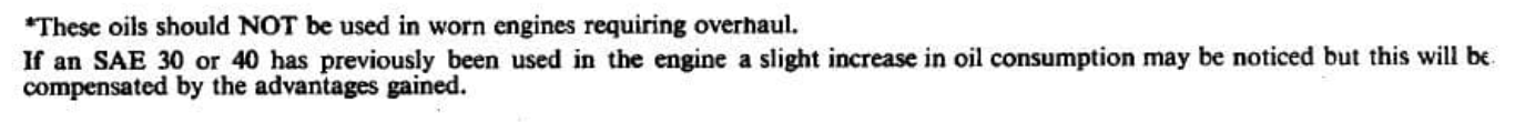

BTW I'm a Tribologist that worked for a Supermajor oilco for my entire career. And don't put any additives (mouse milk) into your oil. Most are just VI improver & make the oil as thick as hell & ruins a properly balanced lubricant formulation. Any modern manufacturer would immediately void your warranty the minute they analysed the oil and found additive addition.
Jaguar's original viscosity recommendations for the XK engine. These engines are not designed to run on treacle. i.e. 20W - 50. It takes too long to circulate around the engine leading to wear at every cold start. Are you sure you don't have a leak? Rear Asbestos rope crankshaft seal being the most common. As Bill comments your consumption is not outside norms for the 3.4 XK engine.

Note: Regent/Caltex/Texaco comment from the S Type Service Manual regarding Havoline SAE 10W-30*. With the 20W-40 they are sticking strictly to Jaguar recommendation (Nothing above an SAE 40).
