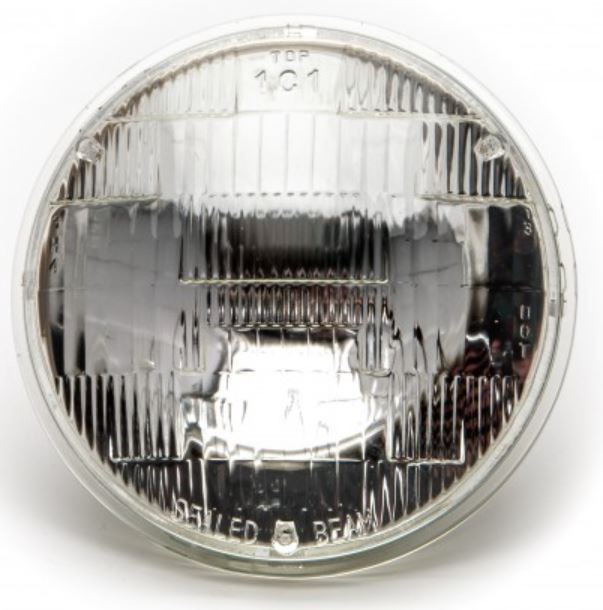

Here is a new one. You can sometimes find as low as GBP 20 for either new or used but working units. It requires patience. This was a very late manufacture. See back it was made by Mazda lighting. There are a number of used on Ebay at the moment. Just make sure they work with the seller.
https://www.ebay.com/itm/303388533191

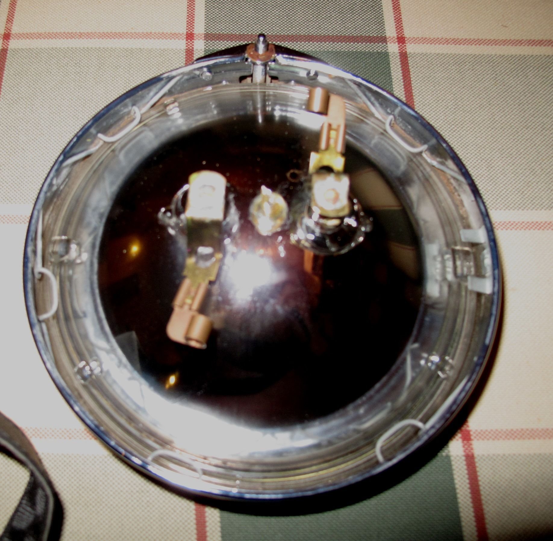

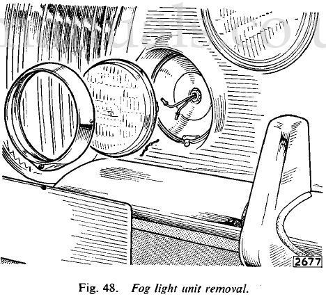

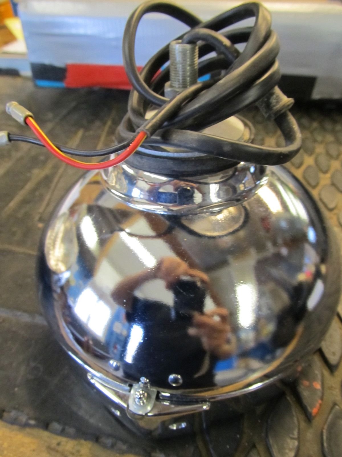

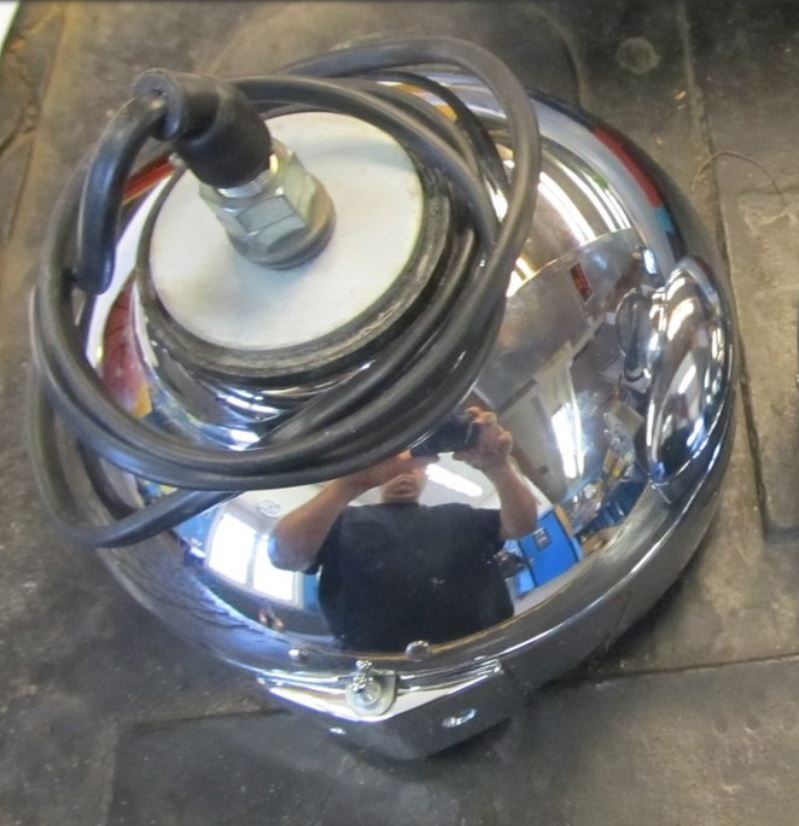

Paddy. Full rear mount foglamp unit as I show above showing mounting rubbers etc to car body and seals & harness protection in the wheel well.
Fog light sealed beam replacement. Remove bezel.
