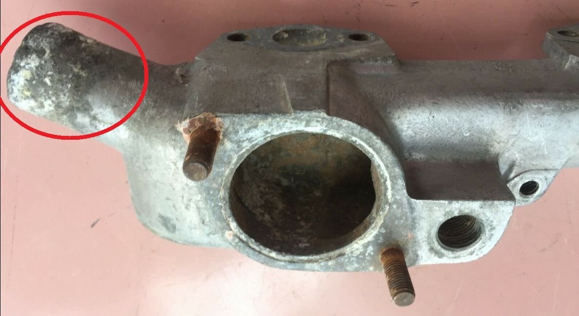

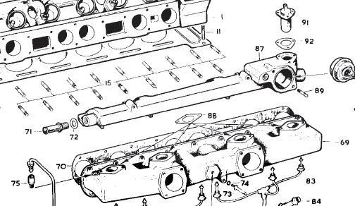

I presume this is what you are looking for C15800. They corrode like mad if people are careless with coolant concentration.
87 here:
87 here:
Yes that's it.
And yes its very corroded at the front of the engine

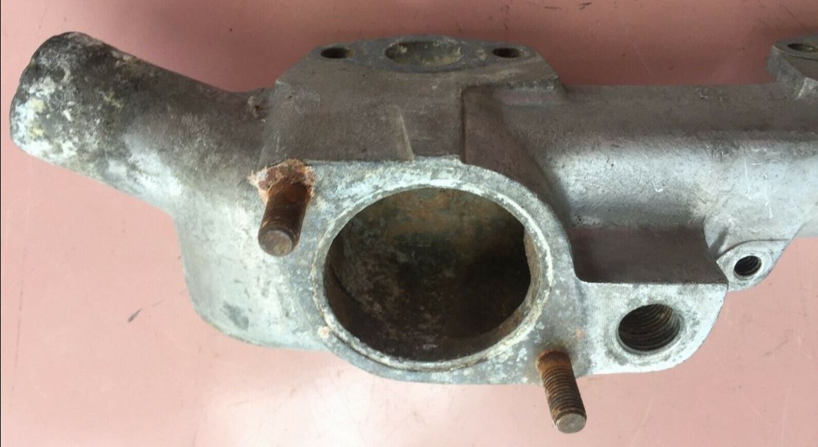

Chris, so where is this hole that can't be repaired ?
The surfaces of the Otter Switch and the thermostat housing are rough, but that can be machined or even block sanded to be made right again.
Getting the studs out would be the challenge, but doable.
A Dremel tool can be used to cut all the corrosion out of the inlet feed and JB weld works well to repair the aluminum, I've done that before in this area and it lasts.
Mine was worse then yours in that area, by the time I cut out all the white oxidized aluminum, I had holes through the casting.

This is not my water rail, just using the image posted by Glynn as a reference.
The hole is at the junction of the hose connection and the thermostat housing.
When the guy tried to build up the aluminium the hole blew through

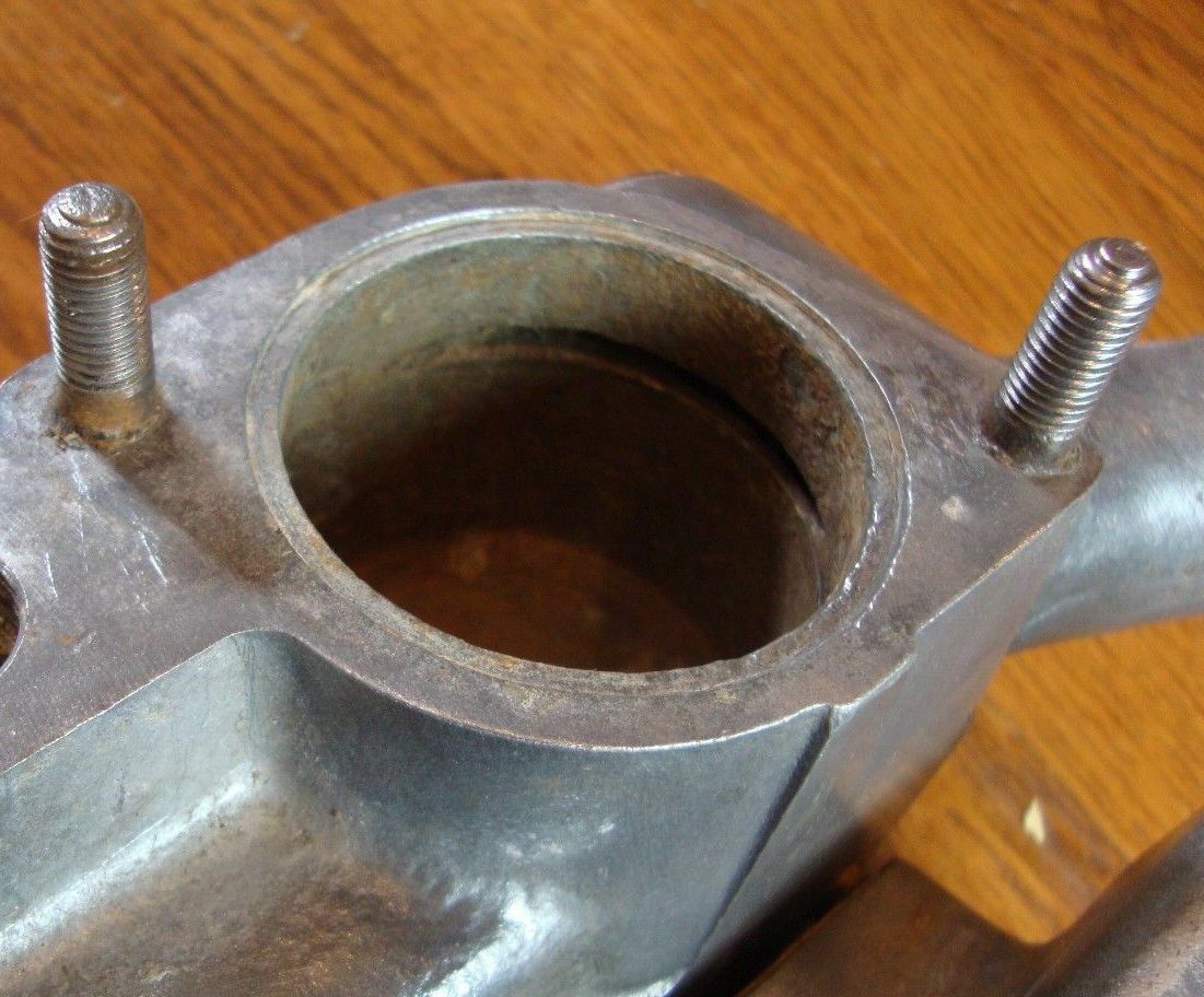

This portion of the manifold is very susceptible to corrosion when people don't maintain coolant concentration.
Unfortunately this pic partially cuts it off but finding manifolds in this condition is difficult. (pre polishing & Chem cleaning)

I'll consider my self lucky, I was even able to get the studs out with no problem.
Who ever the last owners were must have diligently changed the coolant on a regular bases.

You are. I've seen that tube/pipe corrode right off. Luckily my car was OK.
