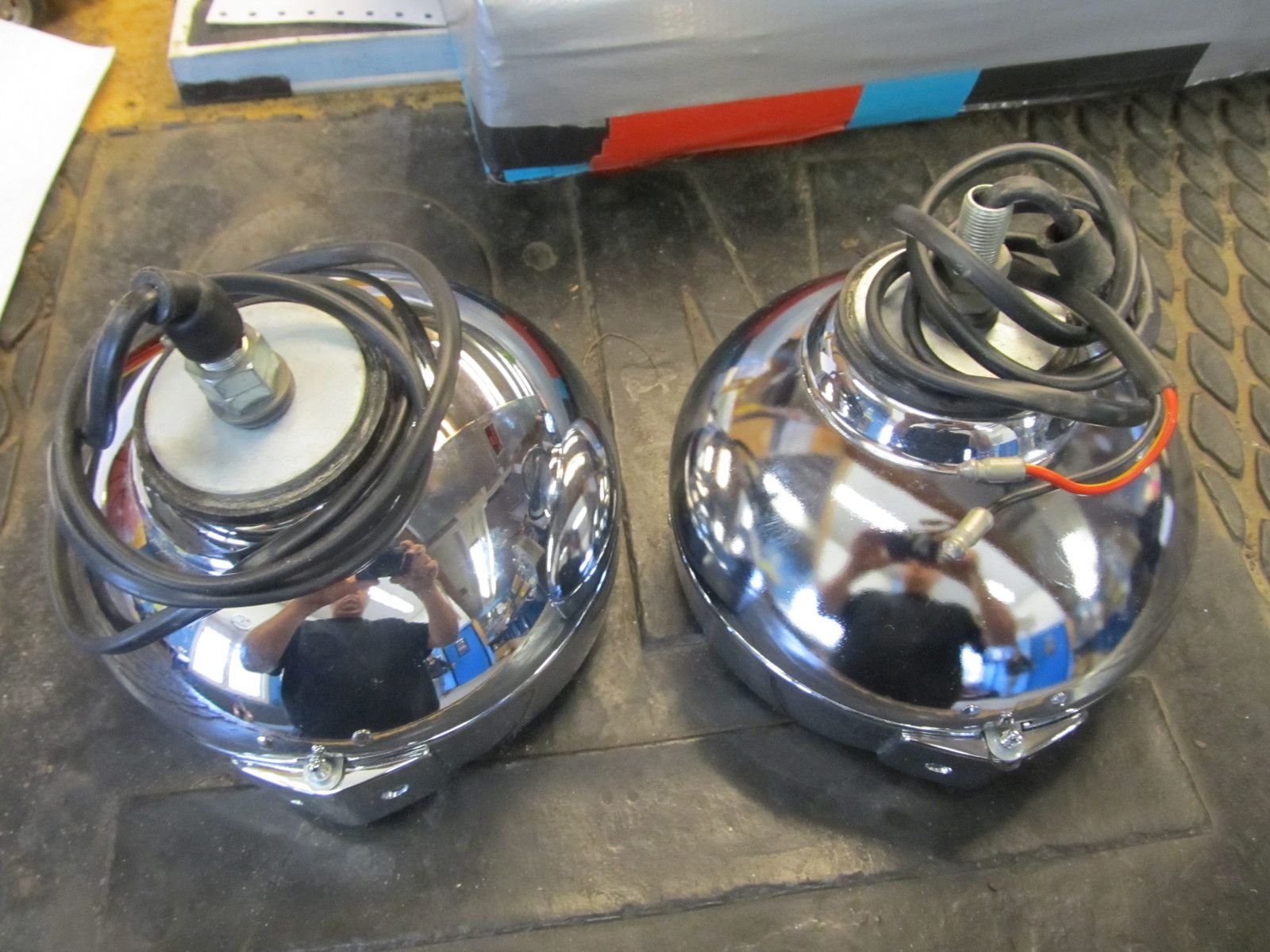

Got a nice set of NOS Foglamps on Ebay for $100 & bought up a number of Lucas NOS sealed beams for them in case of failure. The FT6 sealed beam was fitted to many Lucas bumper mount lights etc. and to the Rover P5B. Be prepared to throw away some chrome outers. Fitted Lucas H4's for main lights with Xenon lamps. Remember headlights come in dip to the left for RHD cars & dip to the right for LHD cars. You can get the original headlight 7" sealed beams with the round centre Lucas logo from India new but you probably want something a little brighter.
My originals were sandblasted from high speed travel in South Africa. Mazda lighting were the last people to manufacture the genuine Lucas FT6 foglamp sealed beam.

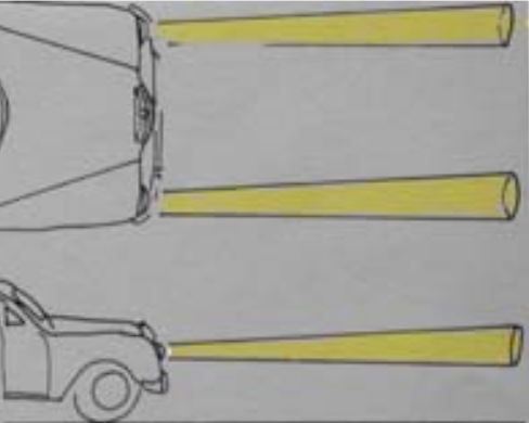

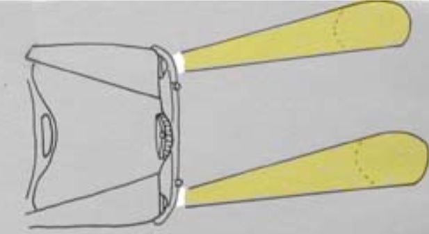

The H4 is also replaceable lamp obviously & prefocus.
The H4 is readily available dipping in the correct direction for RHD cars. Remember most of Europe is LHD.
Highbeam
Dip to left for RHD car.

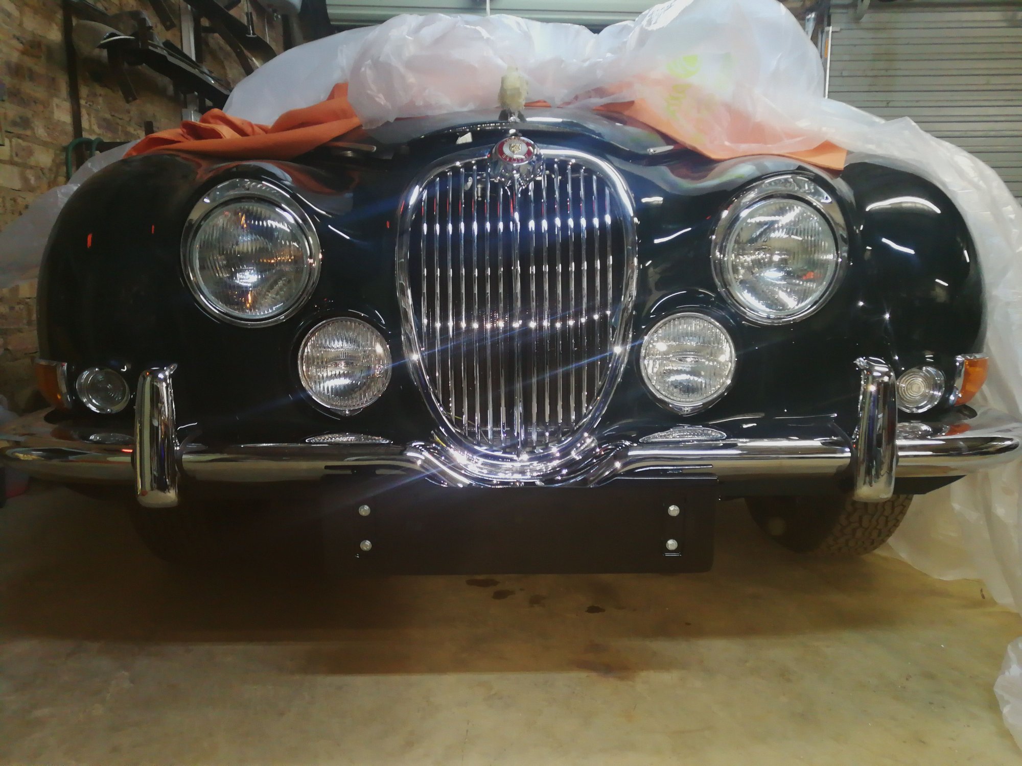

Ah! Thanks for the clarification Peter. I know Fograngers can be trouble. The S Type sealed beam is trouble free (sealed) & the casings & harness etc. are completely sealed from water & debris.
I of course wanted to be totally original & even have a pair of new spare 7 inch sealed beams with the centre Lucas logo should I ever want to make the headlights original for a show etc instead of the H4's.
Like so.

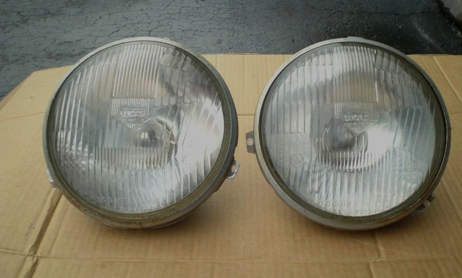

I have a set of Lucas European 700 headlamps that came off a 1966 Swedish S type that ended in North Florida. The car was left hand drive so I assume the lamps are too. The lamps are beautifully made with replaceable low/high beam bulbs. Haven't tried them in my car but that is the plan. I understand you can replace the stock bulbs with more powerful ones like quartz or led. As long as I don't have to add relays or replace wiring, I want to fit them. A store in the Netherlands still sells the original bulbs.

Swedish Headlamps will dip the wrong way,
