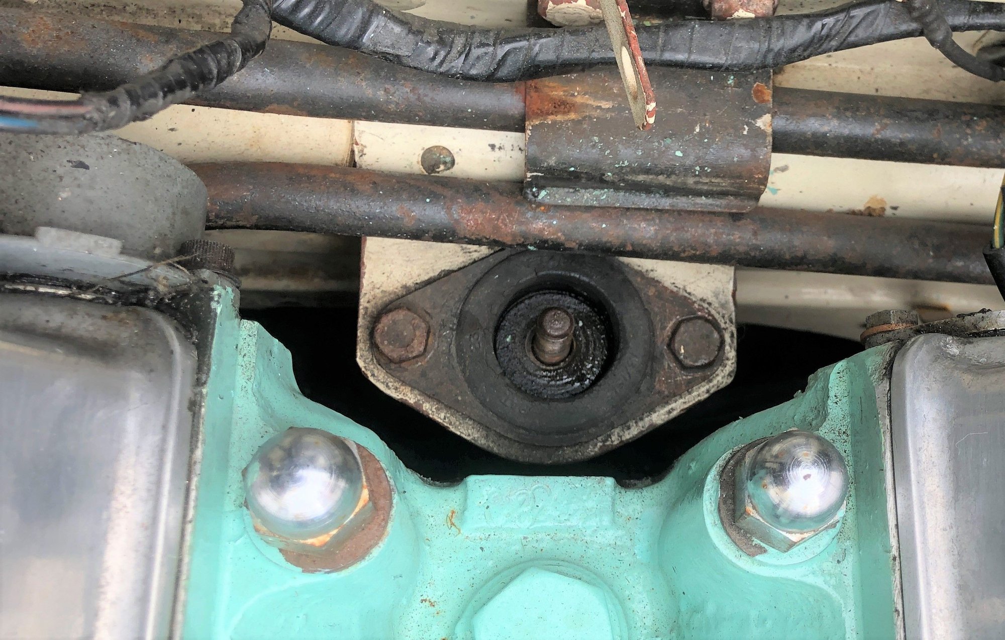

I don't have the front stabilizers on my 1967 S Type so someone else will have to tell you how to change these if you have them fitted. The rear stabilizer mount is difficult to get to due to its position down the back of the engine. The bonnet has to be removed and you end up lying across the wing so add some protection for your paint work. Undo the top bolt where it is in the bracket on the bulkhead and remove this with the washer. There are then two bolts holding the mount to the bracket and with a little fiddling the rubber bush and sleeve can be prised out and replaced. The bottom where it is attached to the bell housing does not have to be touched. The difficulty here is space to get your hand in the gap and the fact you are leaning across the wing. The blue book tells you how to tighten the mount correctly.

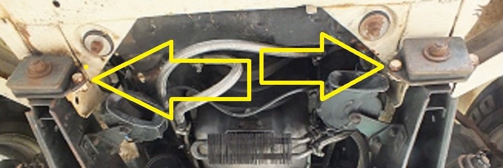

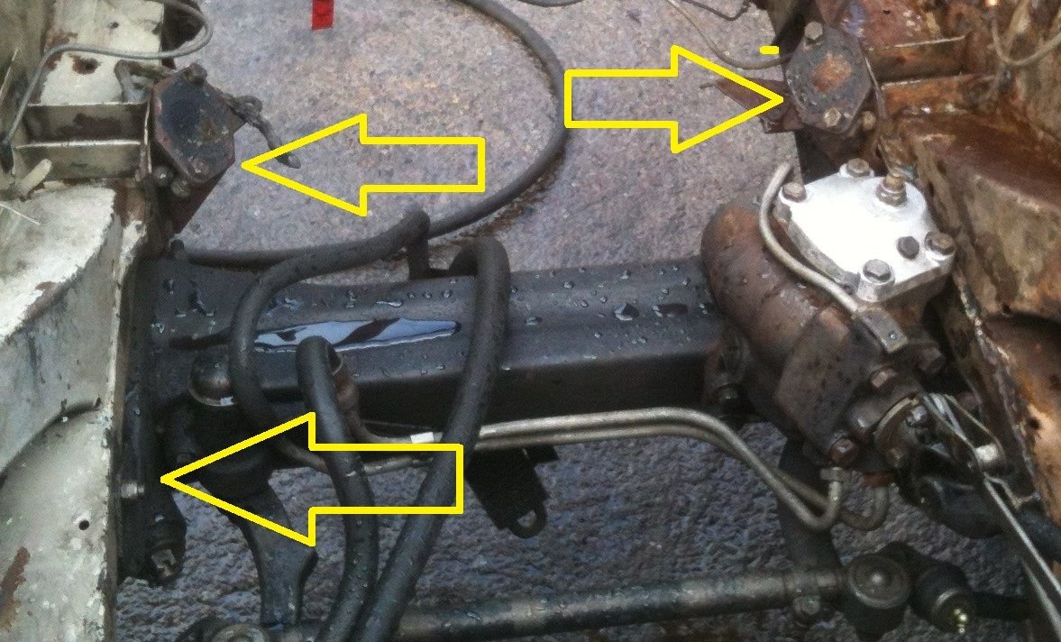

The front cross member mounts are fairly easy. Jack the body of the car up and set it on axle stands. Remove the front wheels to gain access to the mounts via the wheel wells. Place a jack under the cross member and undo the bolts holding the four mounts in place. There are two holding the mount to the subframe and one bolt at the top going through the chassis rail. Lower the cross member a couple of inches so the mounts can be removed and reverse everything to reinstall the new ones. Due to the distances you are moving the engine and cross member nothing needs removing to change the mounts. The mounts are a tight fit over the chassis rail so might need a tap or two to get them on which might damage your paint work. if they are tight spreading the wings on the mount a fraction so they are able to slide on will help and when the bolt is tightened the wings should cinch back up.
Two plates that the engine mounts sit on showing the bolts that hold the mount to these plates. Lower left is the single bolt that holds the top of the subframe mount to the chassis rail. There are then two bolts that hold the mount to the subframe.
Rear stabilizer mount.
Rear stabilizer mount with the top bolt and washer removed. Two bolts shown hold the bush in place. Very fiddly to remove due to the space you have to work in.

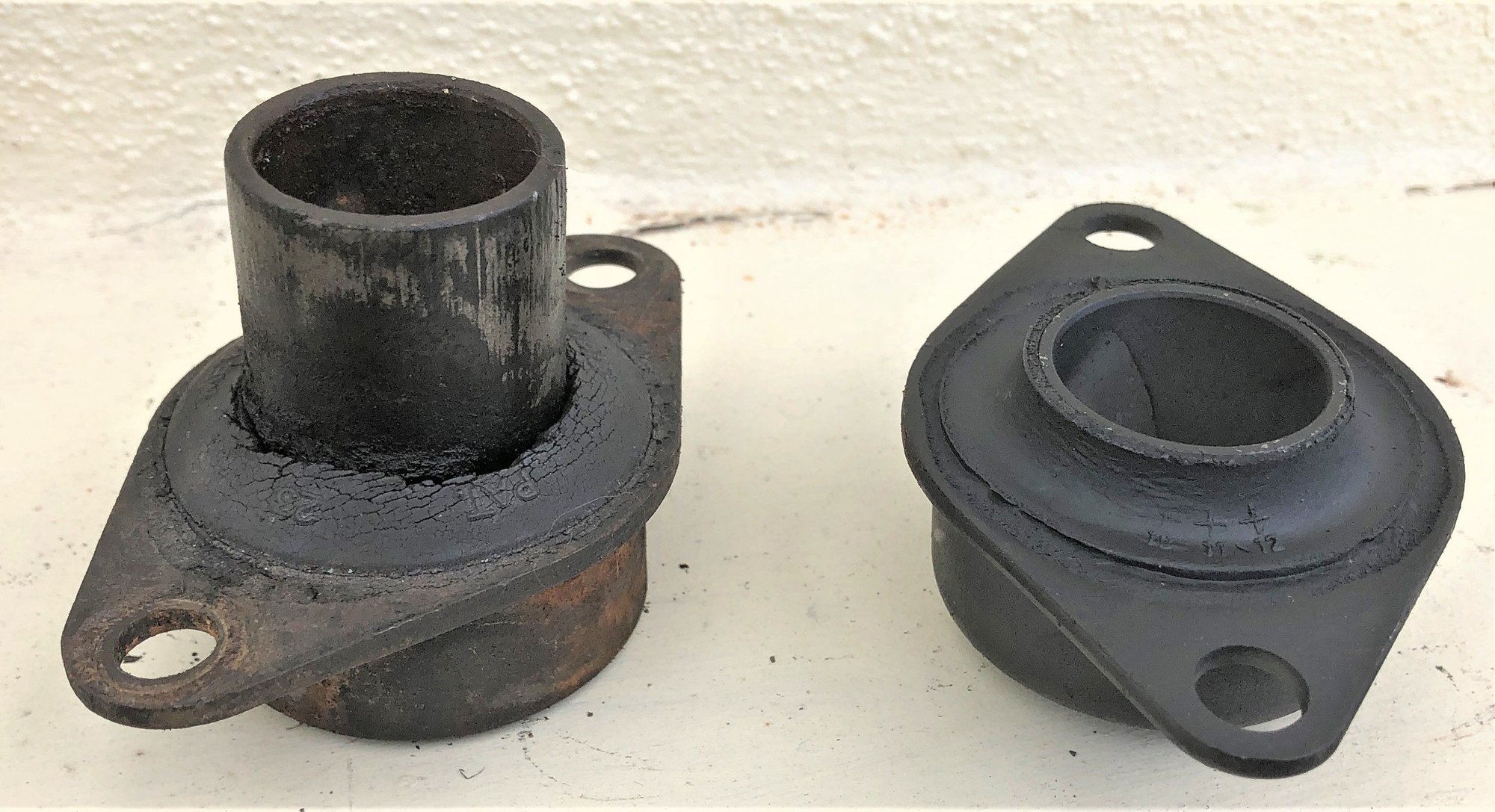

Old mount on the left where the metal sleeve had parted from the rubber. New mount on the right.
The mounts at the front of the subframe. Two bolts hold it to the chassis rail and one in the centre holding it to the subframe.
