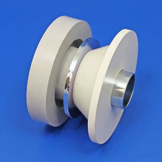

Do you have wire wheels or steel wheels.
Steel wheels are easily balance correctly at any tyre shop but wire wheels need a set of cones to balance them correctly. It is down to the way the edge of the wheel sits against the edge of the balancing equipment. Wire wheels need to be set on the cones to make them run true.
https://www.flexolite.co.uk/products...42mm_hubs-sbc1

My experience with modern tyre shops is that they have little or no knowledge of balancing wire wheels and do not have the cones to do the job anyway. I purchased a set of cones several years ago which I take with me whenever I have the wheels balanced and I have to explain how they should be used. I have several friends with classic cars with wire wheels and they all borrow my cones when they need their wheels balanced.

How to choose the cones matching with the wire wheels features ?
How to be sure that theses cones will mount on the balancing equipment (in France for instance) ?

There are two sizes of cones for wire wheels. 42mm cones are for smaller wheels fitted to the MGs, Healy's and Morgan's. The larger 52mm cones will fit all the Mk2 Jaguar derivatives.
At my tyre shop they have two wheel balancing machines and unfortunately the machines have two different sized spindles so my cones only fit one of the machines. I just hope they do not upgrade this balancing machine in the near future to one my cones do not fit. Once you have the cones just go to the tyre shop and see if they fit. If they do not move on to the next until you find a shop with a machine with the right sized spindle. Balancing machines are pretty universal so you should find one they will fit.
