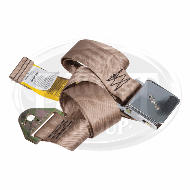

Originally Posted by wouldbeowner
Hello all. I am hoping someone can advise the thread sizes of the three seat belt mounting points for each rear seat belt. I think i have found the holes. They are threaded and in the right places however it looks a bit like they are all the same size. If anyone knows the thread sizes that would great.
I bought these seat belts with the Jaguar emblem for the rear seats of my Jaguar 3.8s (BF2004/11) https://www.sngbarratt.com/us/#!/Eng...9-28e22ce2f460 and purchased the eye bolts they recommended (BF2005). It works find to provide simple lap belts so the people in the rear have something for safety.
