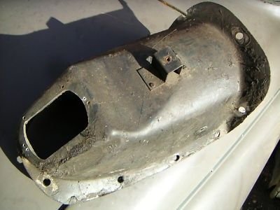

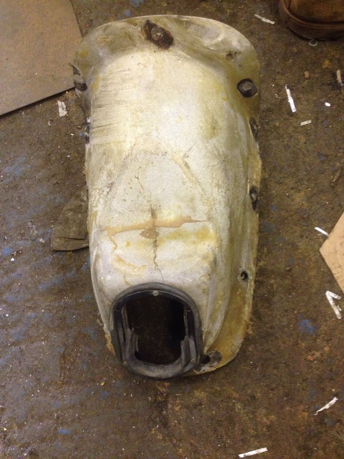

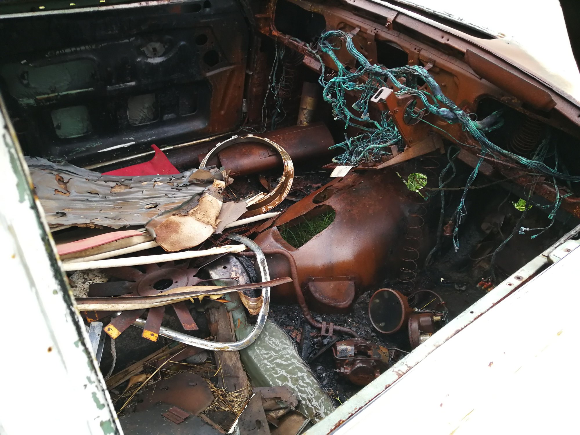

These are mainly S Type pics but give you some idea. (same floorpan from scuttle to rear of seatback) Sorry ~ car got partially burnt in a brush fire after we had taken what we wanted.
Modified Auto tunnel: (you need to make up a cover & sort out a gaiter around the gear stick. You also need to sort out the rear transmission mount & propshaft length ~ on the S Type the Auto console is quite different to the Manual ~ don't know on the Mk2)
This is a manual tunnel & cover.

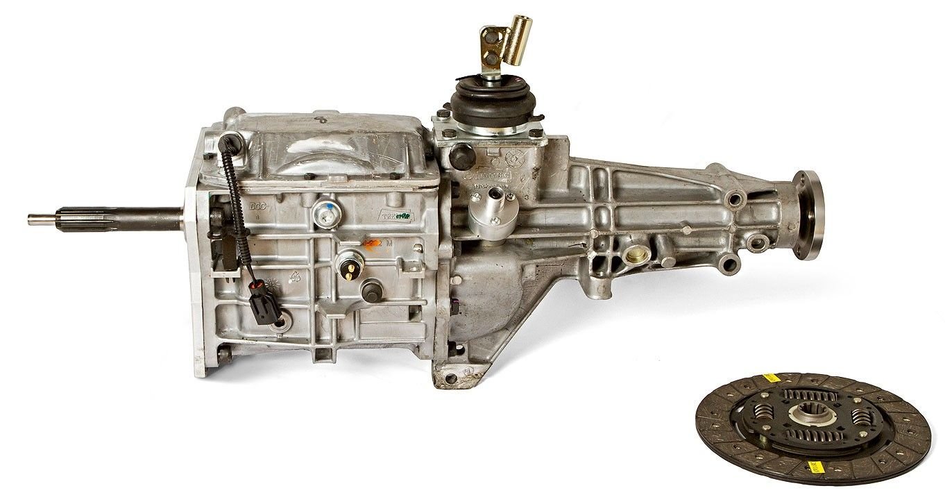

Tremec T5 for Jaguar Mk2 (Longtail). For standard Jaguar bellhousing.
