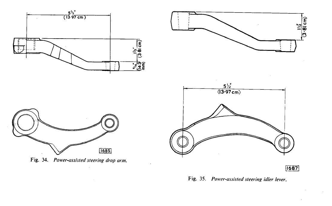

Ideally when upgrading to power steering you should upgrade the drop & idler arms to the beefed up power steering units. The standard drop & idler arms are easily bent if you turn against a curb etc. once power steering is fitted.
PS Drop & idler.
Puny non PS drop & idlers arms
