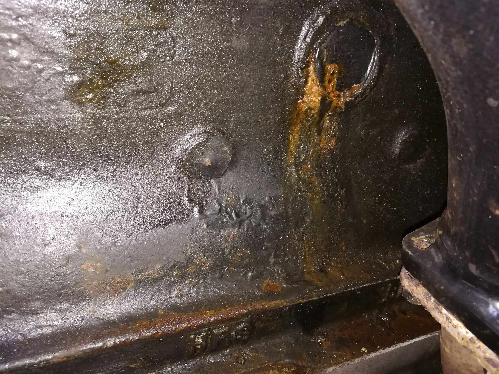

OK, so just been out and looked. The head gasket is definitely gone, there is now coolant on the dipstick
I think I've found the culprit as well, one of the core plugs is definitely shot..

Looks done...

A core plug going is not the cause of the HGF, assuming you have an HGF. Corrosion elsewhere in the cooling circuit could be causing coolant to get into the oil. On my last XJ, I found serious corrosion of the timing chest cover where the coolant passage into the block is located. By all means lift the head, (its probably a prudent move if it's never been off before), but this may not be the end of the problem. Certainly replacement of all the core plugs would be prudent as well. A lot of owners never put anti-freeze in the coolant if they lived in warm climates, but the addition of corrosion inhibitors in the anti-freeze prevents a lot of corrosion. Your core plug looks as if this aspect has been neglected in the past.

I have sent you a PM, now just looked at this, looks like it may be time for a engine overhaul, there looks like no evidence of much anti freeze looking at the gunk coming out of the core plug, I would look at taking the head off, you will soon see what state the waterways are in, they corrode badly where they enter the head and often eat away at the head where the head gasket is, this can be TIG welded back up and the head skimmed.

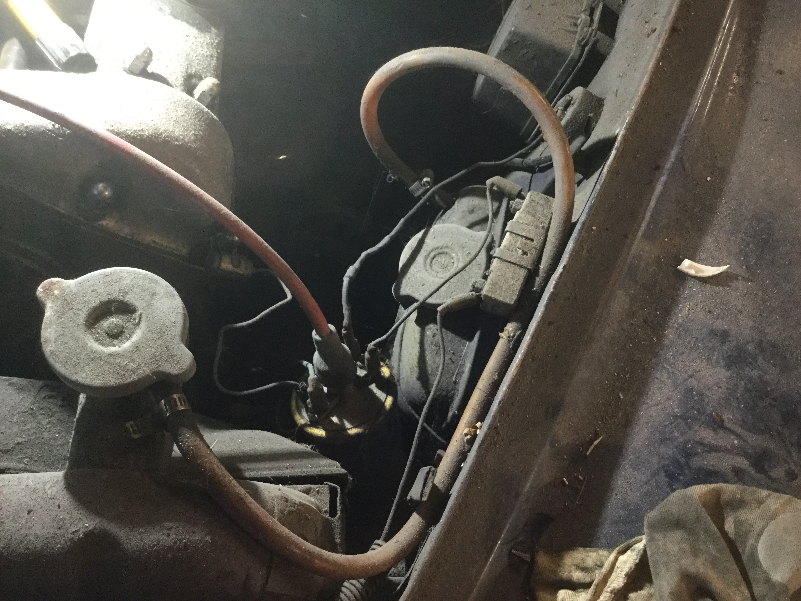

Here is my over flow/recovery tank
