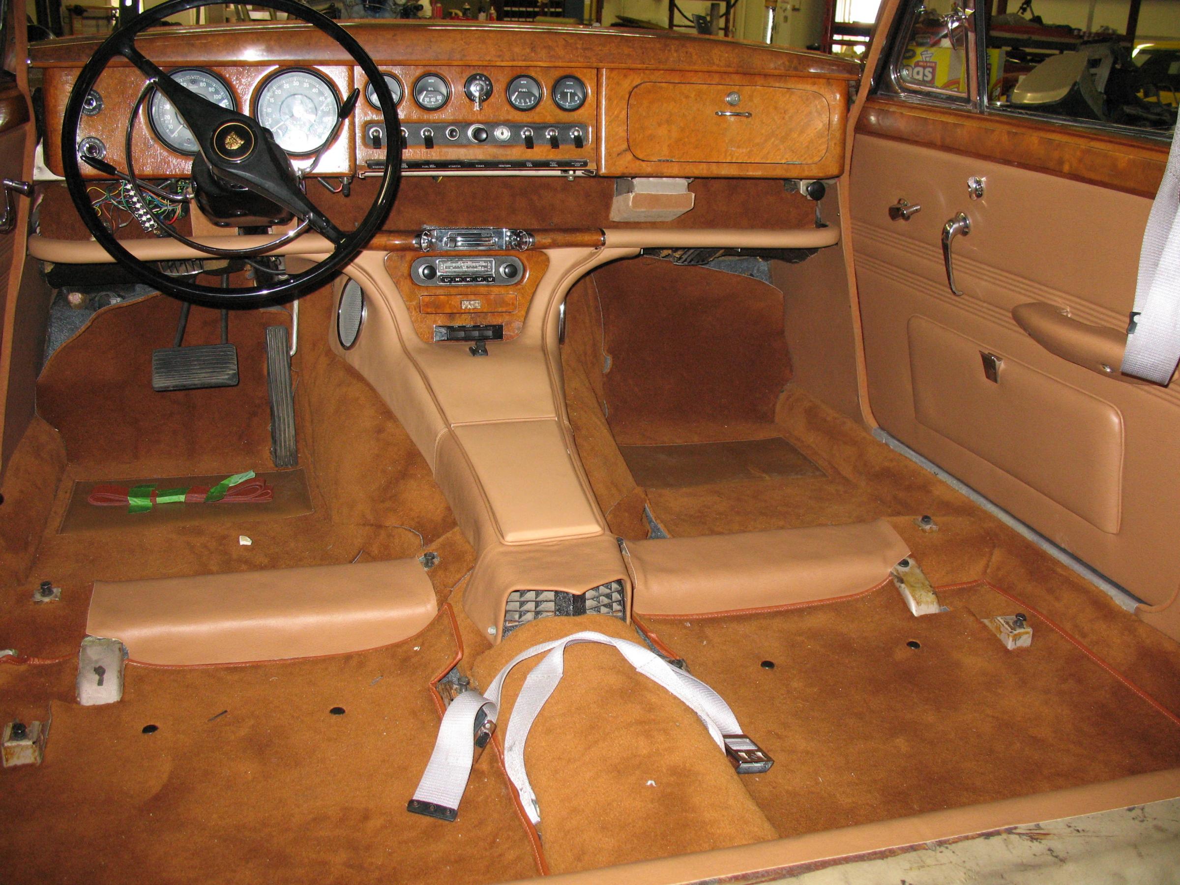

below is a picture of an S type interior without the seats installed, (not my car) showing the seat-mounting points. The 420 interior is identical except for the Dash.

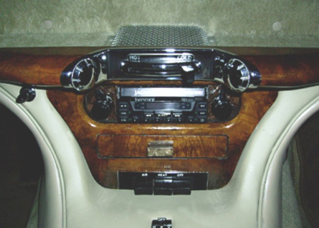

below is a picture of the toggle switch found in my S type for the electric antenna, shown to the left of the radio. I installed a 1980's XJ-6 radio and had to remove the entire console to get it installed right, that's when I noticed the antenna switch says "Lucas".

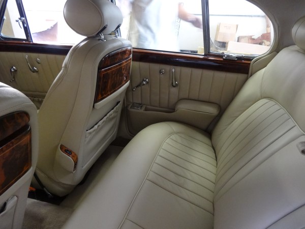

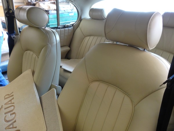

Originally Posted by Tubbs
I wasn't sure where to ask this. I hope this is ok. I have a 1957 Mark II. Will seats from a 1967 Mark II fit in them?
FYI, To me the seats are very important so you feel comfortable and are safely supported in any car. It really is not a big deal to have some minor modifications done either yourself if you are handy or just pay any performance shop that does fabrication of any brand car to make any seat fit into your Jaguar.
There are at least half a dozen that I know on this forum that are like me taking a very modern Jaguar seat or seats and modifying them so they fit and look like it came that way from the factory. As an example (see attached pics) I am taking my Jaguar 1965 3.8s and it now sports full electric reclining leather seats used in modern Jaguar Vadenplas in the front and I had an upholstery shop help modify the back and we were able to section and fit the Vadenplas rear seats to match and so that they feel very comfortable when I have people in the back seats. It is not a big undertaking so my recommendation is put what you want and just modify it so you are happy as it is your car and you are the one that is important....
