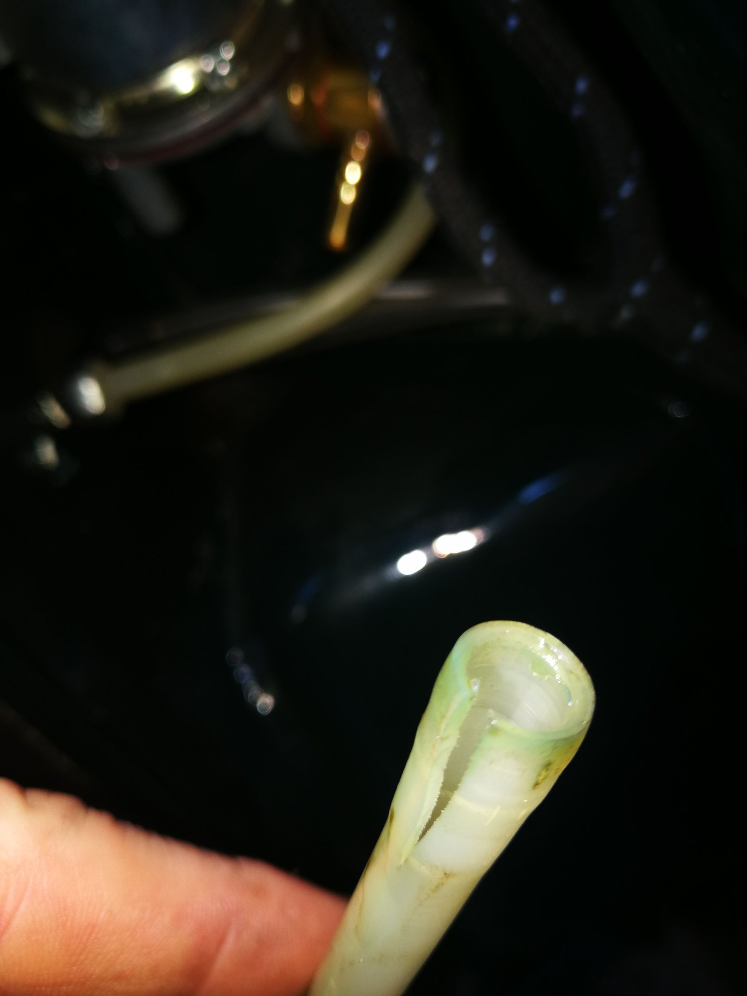

The old nylon fuel hosing used by Jaguar as an example seems quite tolerant of alcohols.
The new hosing sold by many as "the right stuff" looks original but is not alcohol tolerant.
In my car while it was in our alcohol supply area ~ 10 to 12% max it was not.
Approx 3 weeks exposure to gasohol. (see pic)
Old fuel pump diaphragms are also suspect. SU's latest are alcohol tolerant. I have German Hardy pumps fitted to my car & they are happy with 100% alcohol. Huco pumps used by some were not & the diaphragms disintegrated in the presence of alcohol. Since fixed by Huco. They were very responsible with customers that had trouble.
