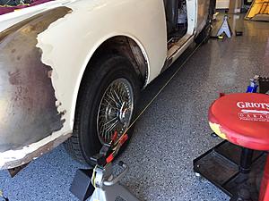

Well, I am back from a little beach vacation and while I did not have a lot of time to work on the Jag today I did make a little progress. Doug, Jeff and others got me thinking about whether my problem was really at the rear of the car.
I have not yet tried to do even any rudimentary alignment because I figured that I would get the car started first, get it turned around (now facing out of the garage), drive it onto my four post lift and then work on alignment when I can easily get under the car.
Just to recap, the problem was that the car would not roll forward though I could push it backwards without resistance.
So, after thinking about the issue all week while away, I was determined to first establish if my problem was the front of the car, the back of the car, or the driveline. I jacked up the rear and put the rear tires on the wheel dollies (see photo below). I don't have a lot of distance to push the car forward before I go out of the garage, but it appeared that with the rear dollies I still had resistance to rolling forward. So, then I put the rear back on the ground, jacked up the front and put the front tires on the dollies. Ah hah, the car seemed to roll forward without much resistance. Perhaps the problem is toe-in as Doug suggested?
I have new brake calipers in the front, new pads and new bearings. The tires/wheels spin freely when off the ground. Tomorrow I will adjust the toe-in and see if that solves the problem. At least it is an easy job. However, I remain puzzled by the fact that the car rolls rearward quite easily. If the problem was toe-in wouldn't it also be an issue going backwards?
Let me know if you have any other thoughts otherwise I will be adjusting the tie rods tomorrow and I will let everyone know how it comes out.
Thanks!
Lin

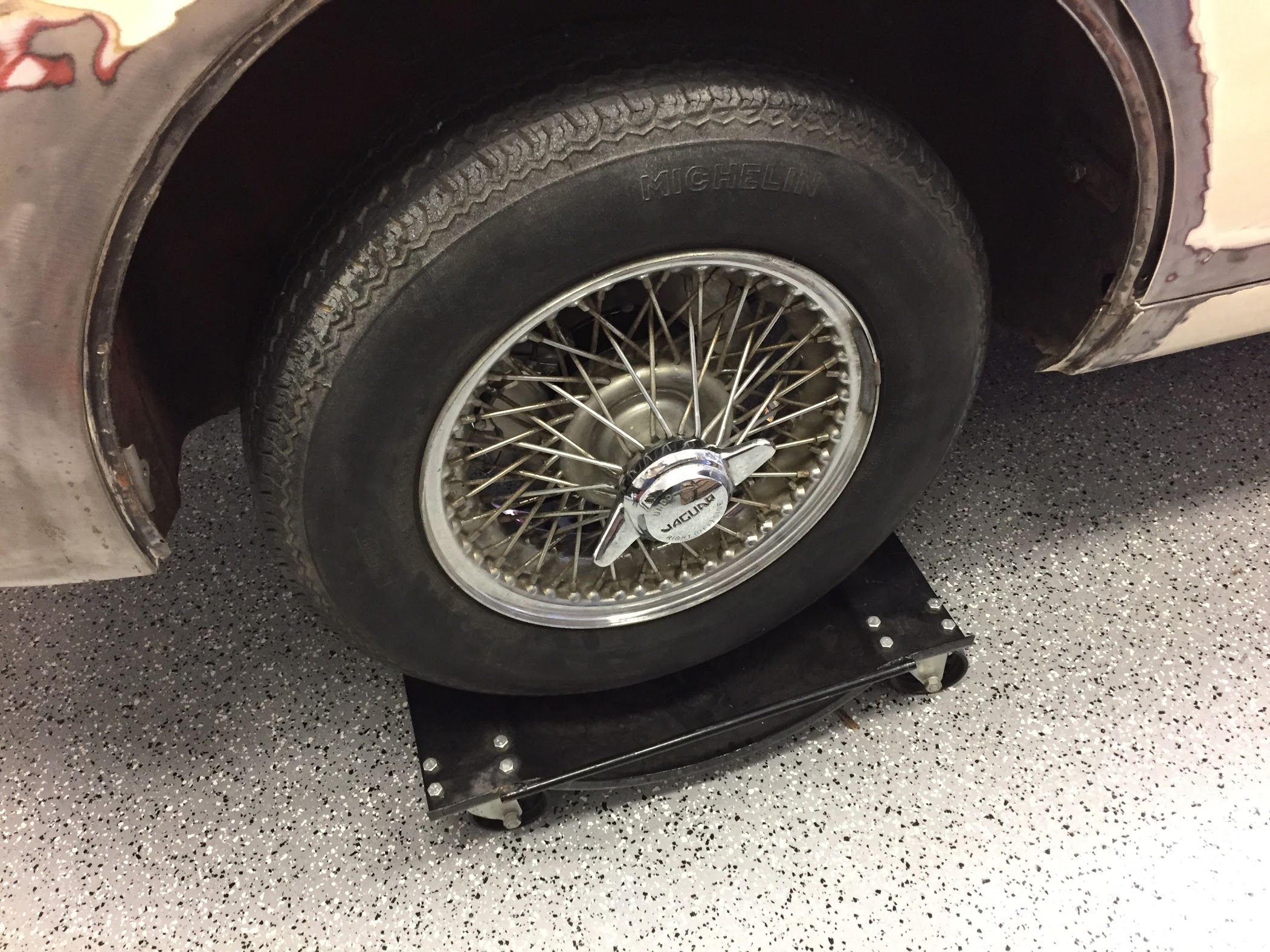

I believe that Doug was the first person to suggest that my problem might be excessive toe-in. He was right!
I am still a little surprised that this turned out to be the problem, but pleased that it was such an easy thing to adjust to fix the problem. At first I just "eye-balled" the alignment and thought I was fairly close, but the car while better would still not roll in a forward motion without some resistance.
So, I got out my floor jacks and string and did a "poor man's alignment." I put some grease on cardboard and put it under each front wheel to make it a little easier to adjust.
This method is just a preliminary to having the alignment done professionally, but lo and behold, it worked and yes, it solved the problem. The car now rolls as well in a forward direction as it does to the rear.
Special thanks to Doug, but thanks to all who offered a thought about what the problem might be. Everything helped. With reference to the subject line, today I am feeling less inept!
