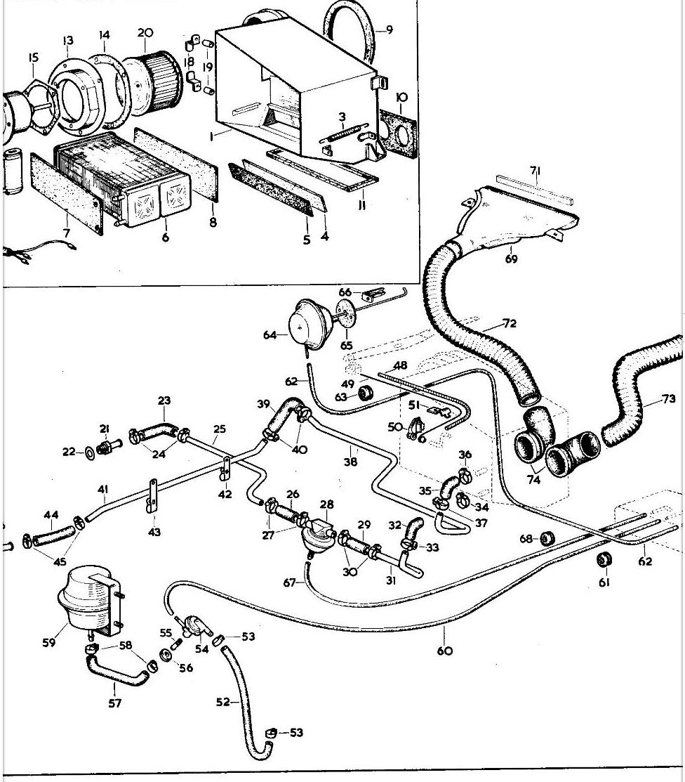

Found it, Reservac tank for heater vacuum controls Part No C26896 in the 420 parts book plate 58 part 59, SNG show it as no longer available !

I may be being stupid Jose, and please correct me, but isn't the part on ebay, item 64 on the parts catalogue picture ? Part No BD25328 Vacuum Assy for scuttle vent ? And not Reservac tank for the heater, or are they interchangeable ?

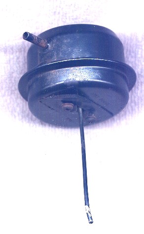

it is the "german helmet"-shaped vacuum tank that Liz showed from the Sovereign, but the ebay picture is shown without the "C" bracket. Apparently there is a part number supercession.
the Scuttle Vent actuator is different, smaller than the Heater Vacuum Tank, and it has a long rod in the rear that connects it to the scuttle vent. It was used in the S type and 420, Daimler Sovereign, 420G, MK-X, 420 Limo, but not in the MK-2 or variants.
