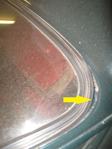

Putting the screens in is not a problem with the correct rubber. Heated rear screen is quite a bit thicker as Rob says. Correct rubber crucial for fit & wire routing.
Only care required with the windscreen is seating the bottom corners properly first or the rubbers can pull away from the bodywork. Correct windscreen rubber should always seem a little large for the job. Windscreen chrome is also easy. Should also be glued as can blow off at speed. As Rob has previously mentioned elsewhere some windscreen chromes have holes in them to allow wiring together under the chrome joint covers.
The "evil" job is the rear screen chrome.
Typical (FRONT) windcreen lower corner pull away

Firm blows may not be the correct term, it should not be used to force a situation that doesn't want to happen.
Certainly if the rubber is the wrong type using ones palm to settle things in may and can cause the screen to break.
When mine was done, one could see the wind shield nicely tuck itself in when the "palm" method was used.
The photo with the broken glass looks like it was pinched in that area where the break started.
