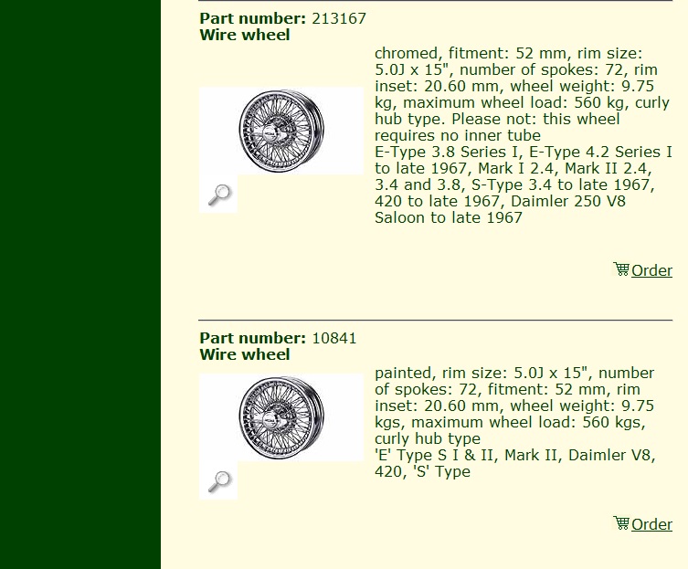

The only information source I could find on this is in the SC Parts catalogue, a UK aftermarket company. Their wire wheels for E-Type and MKII share a common Part Number to 1967:

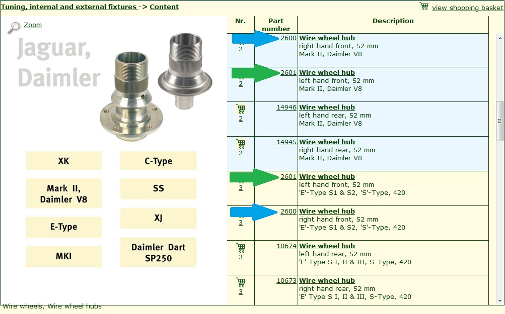

The hubs look to be more complicated:
The fronts are the same but the rears are different Part Numbers. It's many years since I was running Jaguars of that era but I do recall switching from wire to steel was not too simple.
