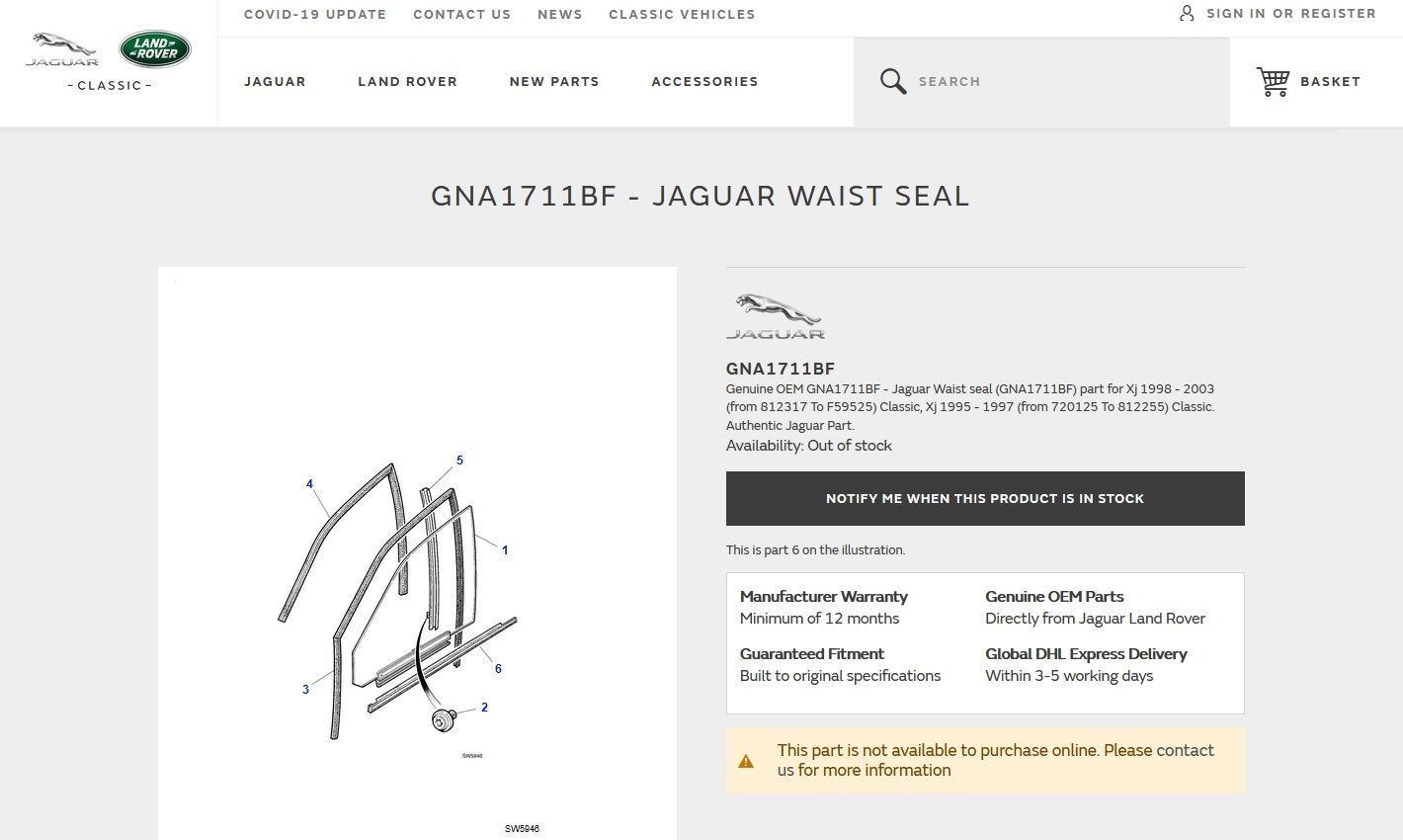

My painter used the term "belt strap" referring to the moulding which holds the rubber seal at the lower side of each window.
I am presuming they are clipped in place. I am having difficulty with their removal. I could use some advice on How To.
Old Nov 10, 2020 | 02:14 AM
Jaguar call these the waist seal or waist rail (see item 6):
They have a series of spring clips securing them to the top of the door panel. Usually they pull off, working gradually backwards and forwards along the lengh to avoid distortion. I can't recall if the X300 has a fixing screw at the end but members in X300 forum with this model will be able to help.
