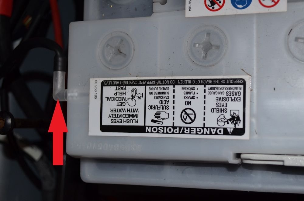

I think you're right about the probability of an earlier overcharge causing the acid damage and bicarb is the way to remove the white fuzz. However, the XK8/XKR MUST have a vented battery with the vent tube exiting through the luggage compartment floor so you should check this is fitted correctly. This is my 2005 XK8:
BATTERY VENT ADAPTER
VENT TUBE EXIT
It looks like you'rfe finding your way around here now but if not, follow this link https://www.jaguarforums.com/forum/xk8-xkr-x100-17/ to the XK8/XKR forum for help, advice and information. The 'HOW TO' thread at the top is a good place to start for information on regular issues.
