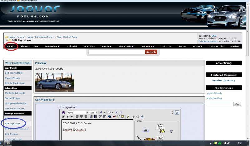

Thanks to all the Administrators. I've been trying to find the signature update but haven't found. maybe the actual names are different than the ones you stated GGG?
Old Aug 28, 2012 | 06:03 PM
Click on the User CP button (circled in RED) on the left of the black menu bar and then on the Edit Signature option (circled in BLUE) under Settings & Options. Enter your details in the dialogue box and press the Save button below the box:
If a picture is worth a thousand words, this should get you there!
