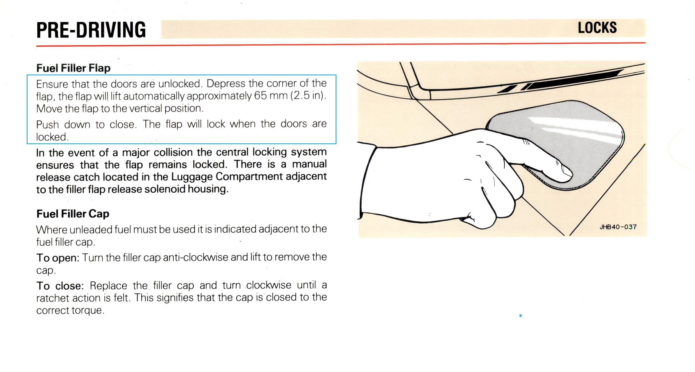

Is there a remote method of opening the fuel filler door, currently have to open the trunk, a bit embarrassing at the pump. Lots of questions concerning the car, but let's start here.

Welcome to the forum JW,
I know you've already found your way to the XJ40 tech section so no need for a link from me.
The Fuel Flap is opened like this (see the section I've boxed in blue):
