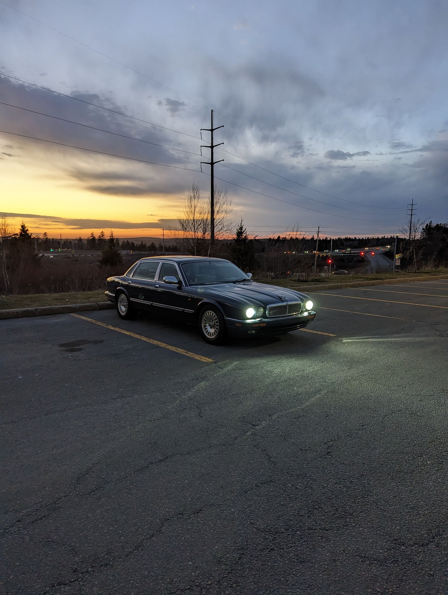

Come va Jaguar forums! Canadian-Italian here with a '96 Vanden Plas.

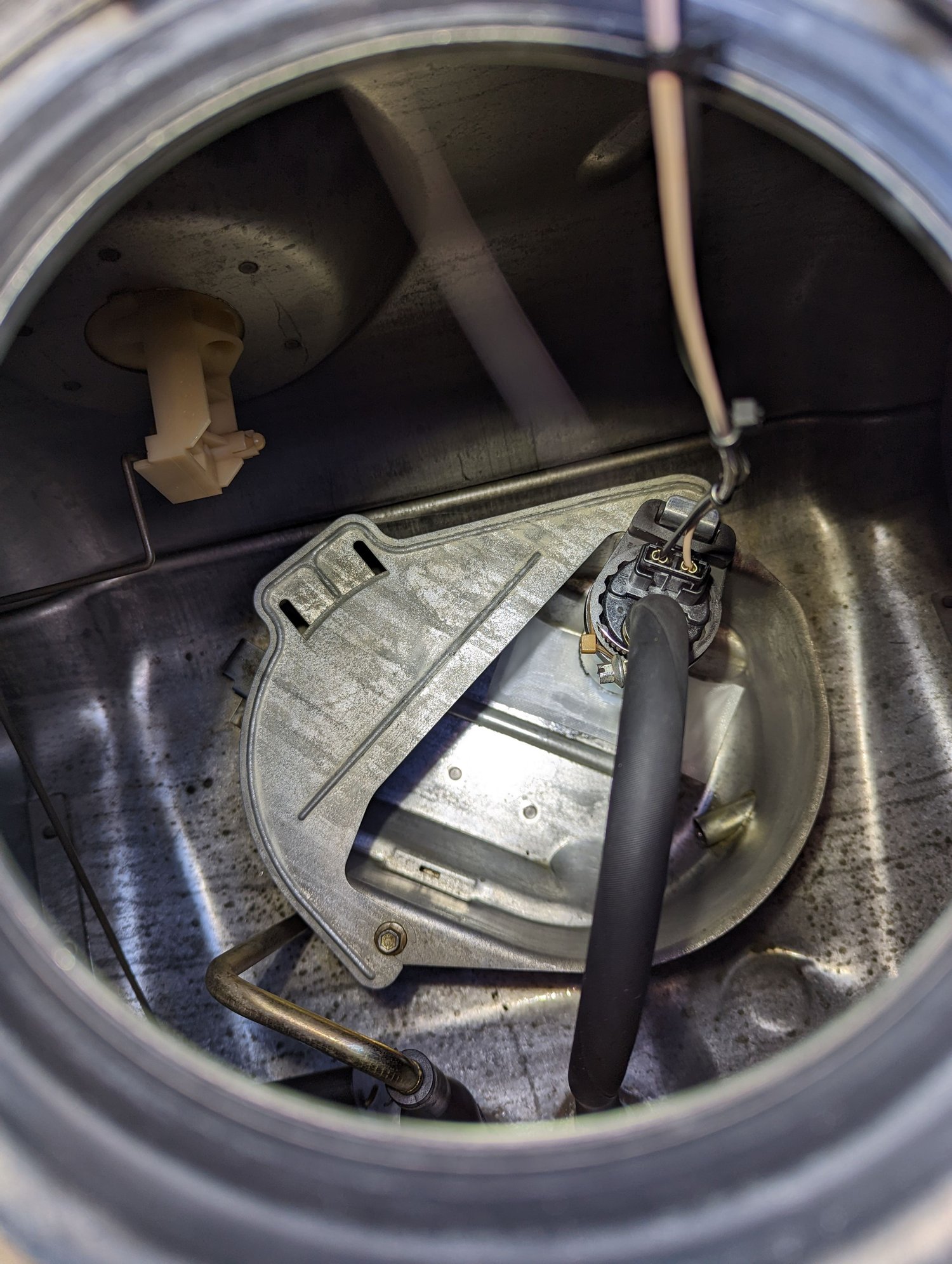

A week into getting the car home I had the common fuel pump failure, annoyingly it happened down at a friends cottage 50km away! I did the easy approach of cutting out the metal body above the evap system on top of the fuel tank, turns out the fuel lines had come off the pump! Either they had come loose over the past 27 years or some monkey was in there before me and didn't tighten down the lines properly.

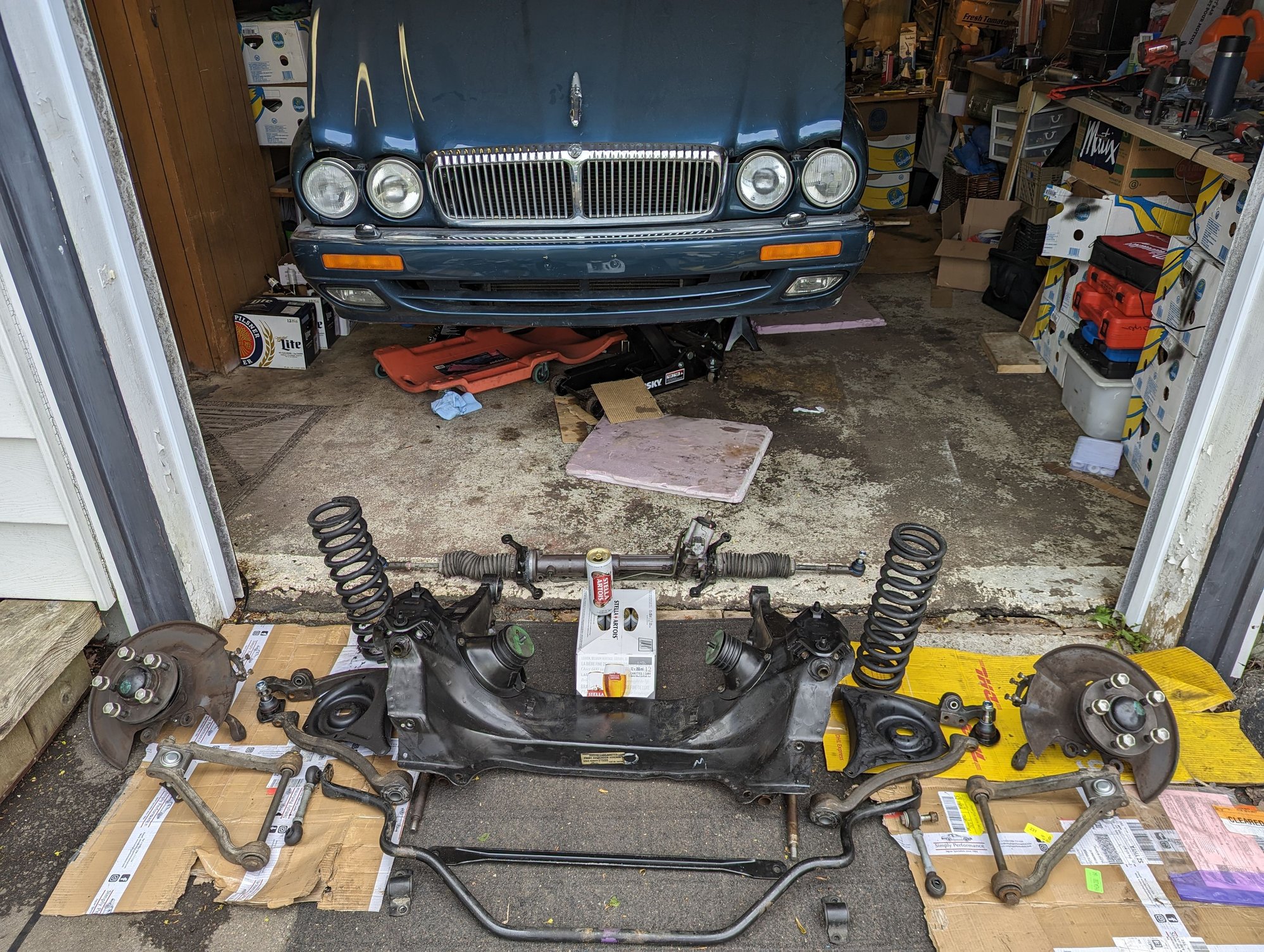

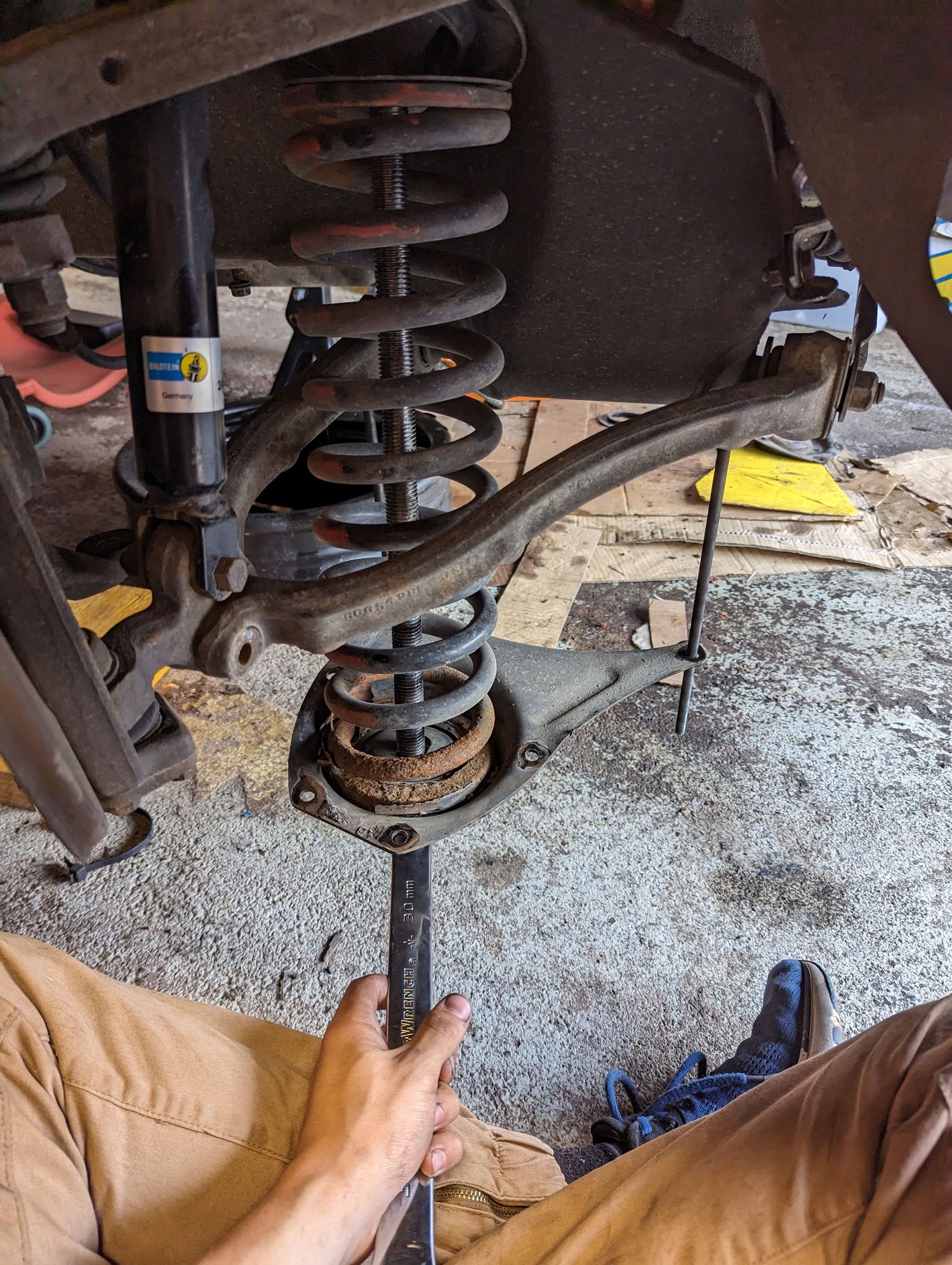

Early on driving the car it developed a front right clunk over bumps, first I thought it was sway bar related so changed the bushings and contacted Andy Stodart for his custom made adjustable end links. They work great, but unfortunately did nothing for the clunking issue. I then decided it was lower control arm or cross member mount related; there was a lot of engine movement too which made me believe I needed new motor mounts. Fast forward to last month I figure out that the clunk was actually from both lower ball joints with destroyed boots, and the infamously garbage lower shock bushings which were absolutely destroyed. I still dropped the springs and subframe and replaced every bushing, mount, and ball joint except for the upper control arm bushings.

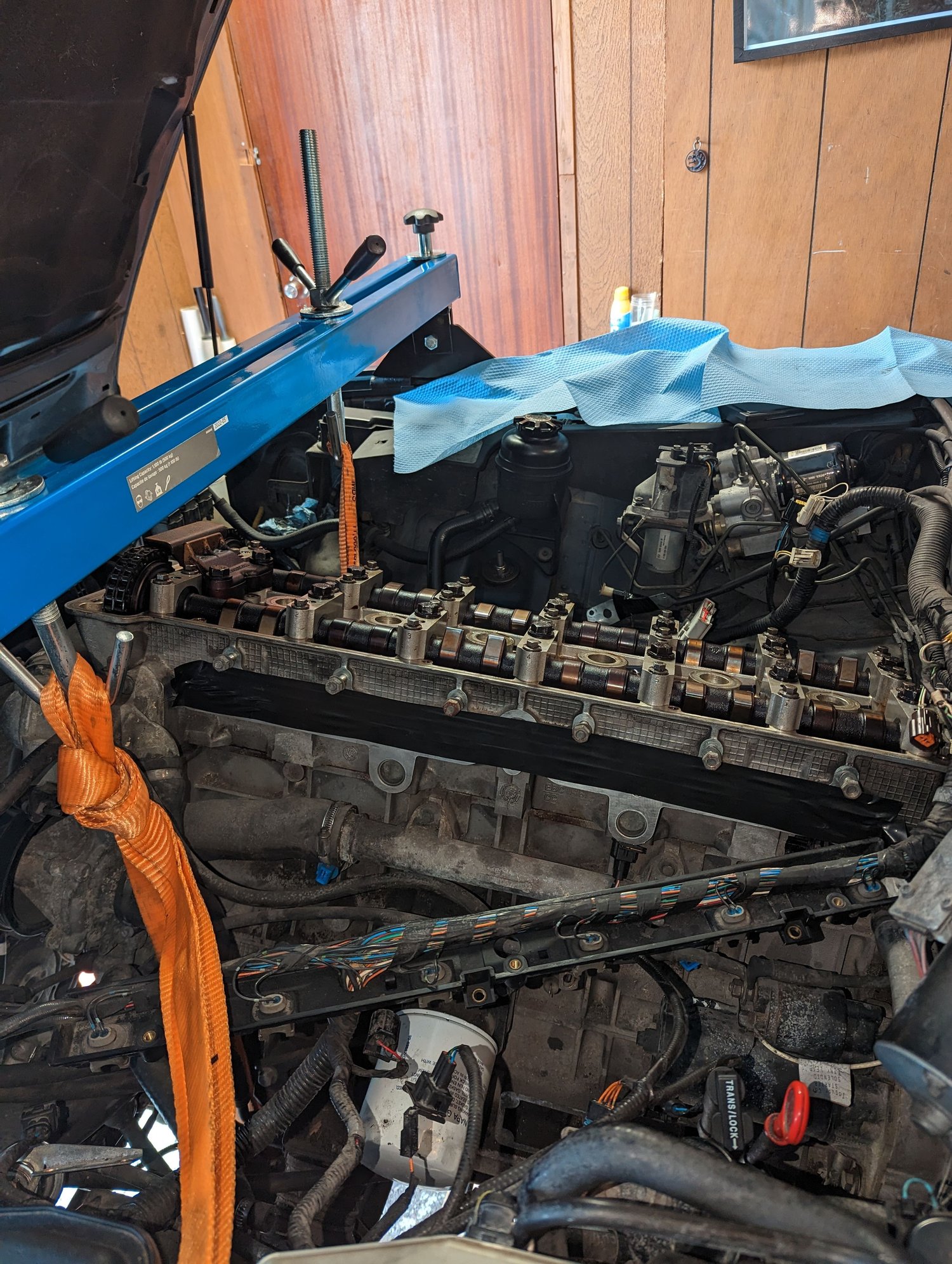

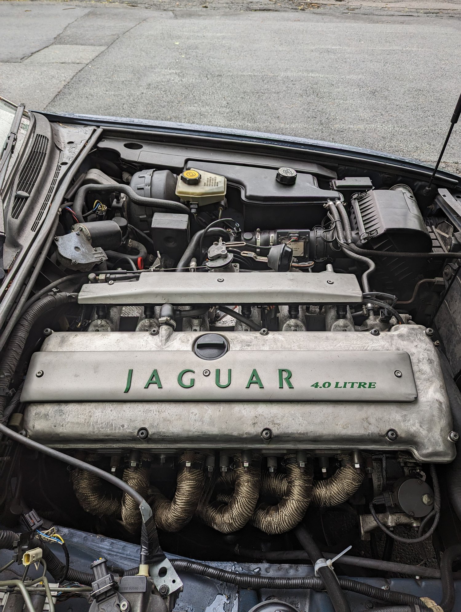

I as well got fancy new stainless steel exhaust headers in place of the notorious cast iron manifolds which I believe were developing cracks. I wrapped these headers in titanium wrap, and they look great and increase exhaust gas flow by a great amount; however, it was a huge pain to work with getting small painful metal fibers literally everywhere and I'm still dealing with exhaust slip joint leaks, so I can't really recommend it (not to mention how much it all cost). I also attempted a valve cover polish, but it was taking too long so I settled with a 'brushed' metal look. Eventually I'll get a donor car and get a glossy polished cover.

You'll be back to the front suspension for those upper wishbone bushes if you didn't replace them.
