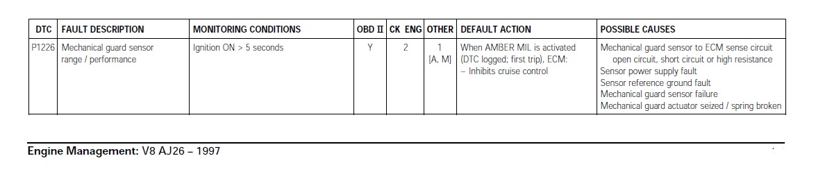

Shortly after its arrival the engine started making a lot of noise which I am guessing is the timing chain. I have stopped driving it until repairs are made. But the main reason for joining the forum is that the "vehicle poor performance" light came on and went off several times before the timing chain got bad. My Actron CP9180 gave me two codes: P1111 and P1226.
I guess I will stop with the introduction and try to find information at this point. I know all about the P1111 and have read some about the P1226, which seems to be a mystery as it is not listed in the Workshop Manual (which I have downloaded) and a lot of people seem to be asking about it.

I'll give you a start with the P1226. Here's the possible causes from the Jaguar DTC Listing for your Model Year:

Thank you so much! Your attachment, which I received almost immediately after making the inquiry about the P1226 code, is more information than I have been able to find in days and days of searching. It is exactly what I was looking for. I don't understand why it isn't in the manual or how you managed to find it, but I am very grateful.
This is very interesting because the person who sold me the car said he was having trouble with the cruise control but had no clue why. And right under "Default Action" your attachment says "Inhibits cruise control." Amazing.

Robert,
Which 'Workshop Manual' have you downloaded?
JTIS (Jaguar Technical Information System) is the factory shop manual for all models from 1995 to 2004.
The extract for P1226 I posted is from the full DTC (Diagnostic Trouble Codes) listing for your Model and Year which forms part of JTIS.
