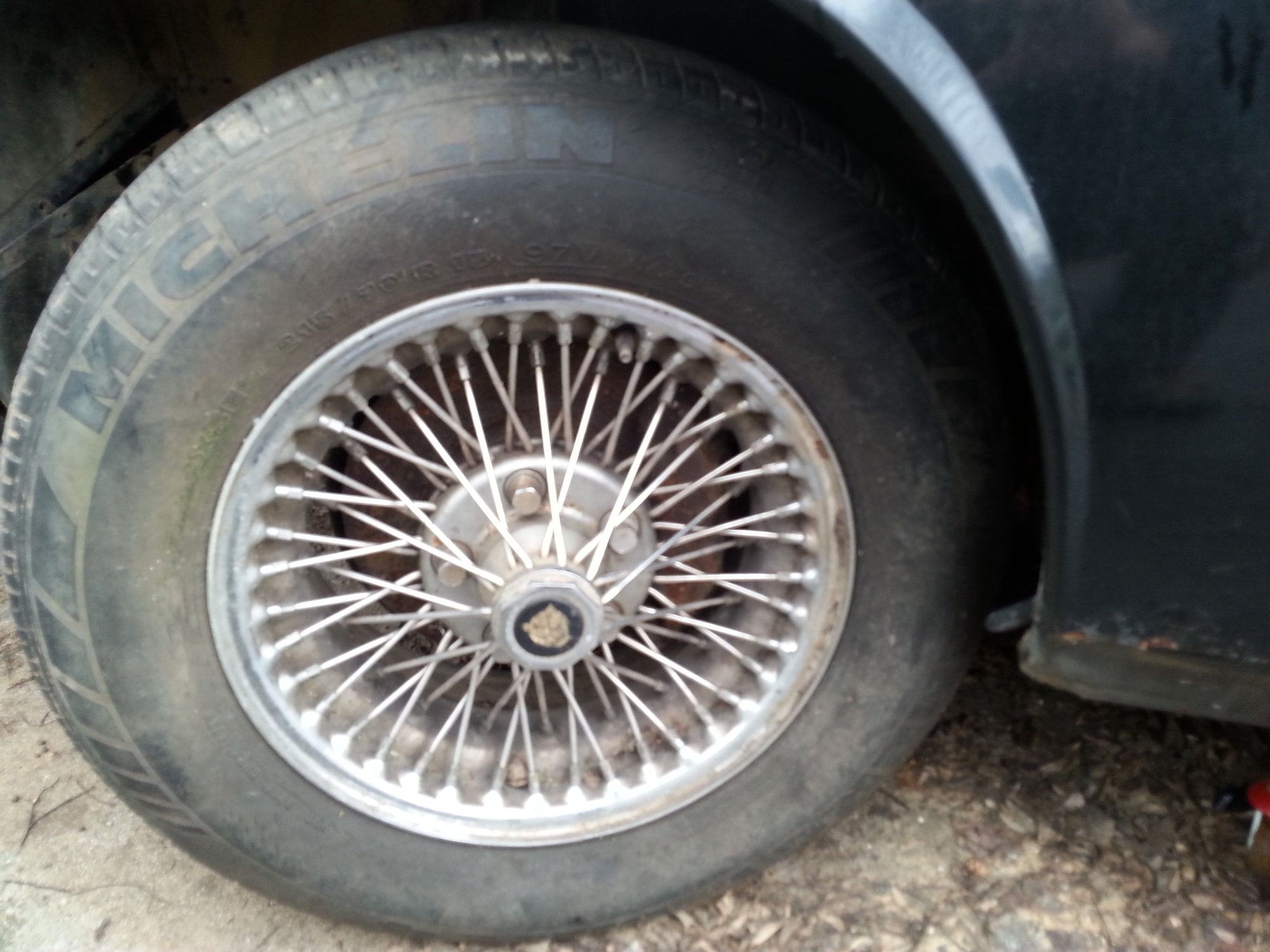

I think it might have some throwback Jaguar wire rims cause I have not seen any images of this model with wire rims. The previous owner had a couple of E type and it does look like those rims. The parts car does in fact have what looks like oem rims. Of course it may just be a a option that was available, my research is in it's infancy
Just the same, I will be taking the possible e type rims off to polish up,( Nope not really anything unusual and definitely not from a E type...) and put the oem rims on while I am working on the vehicle.

Rim's on vehicle

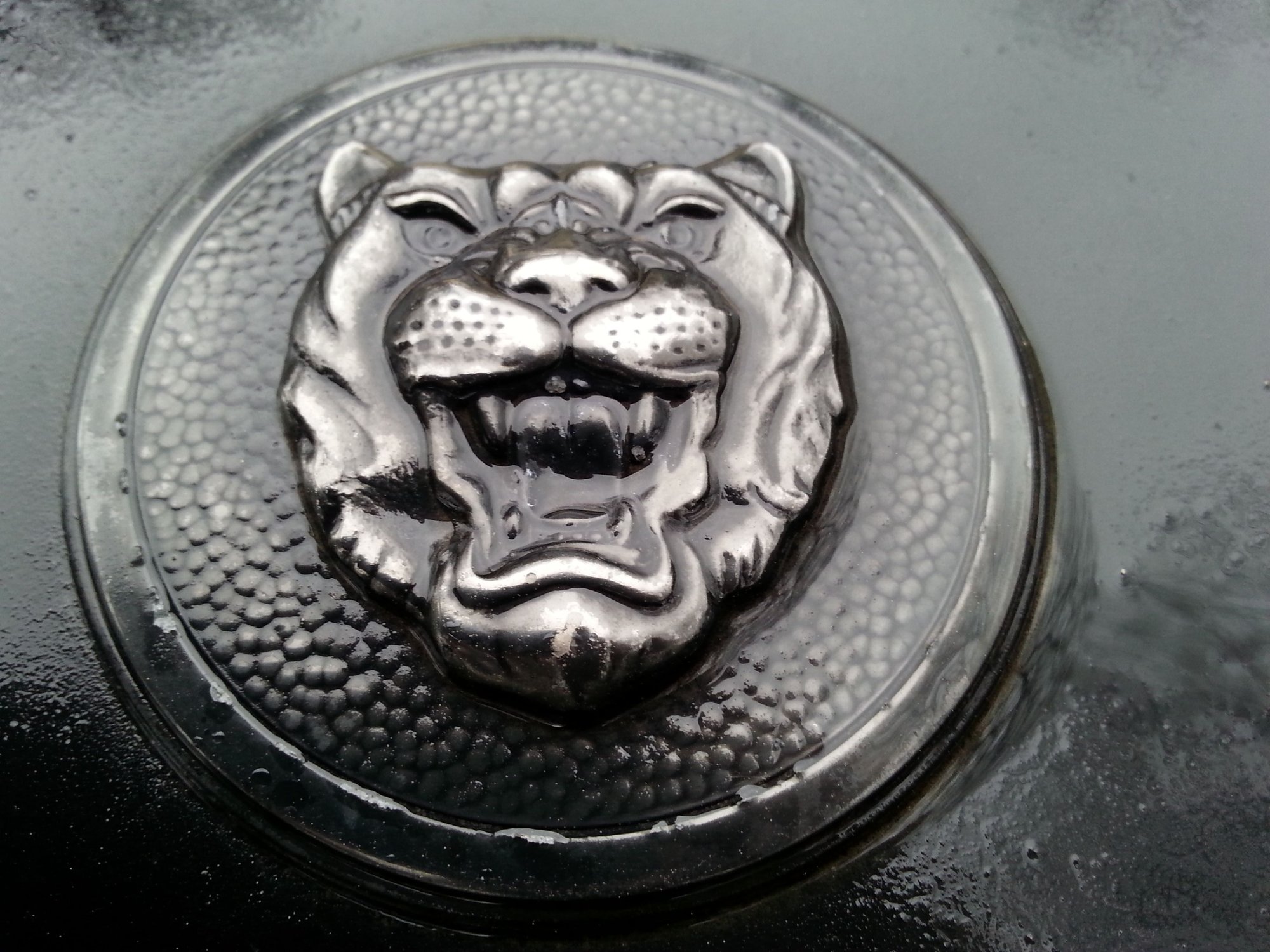

Obligatory Jaguar roundel shot

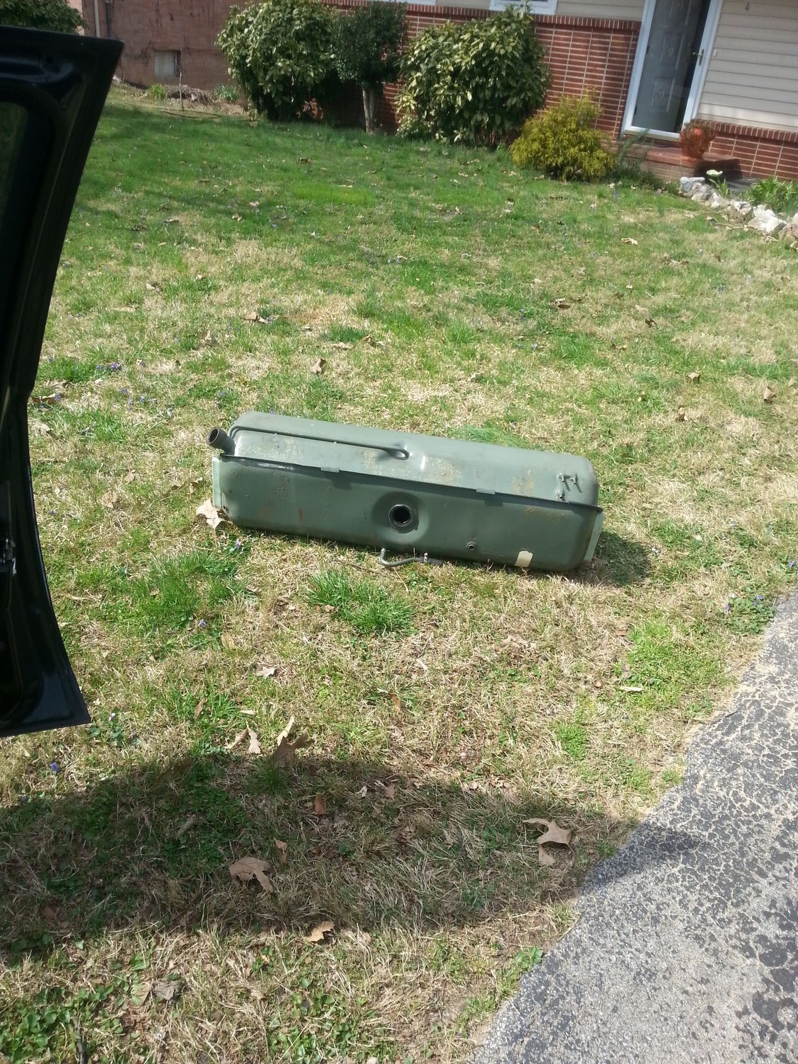

I got the surgetank and gas tank out this weekend. (offerings of appreciation for all those who have gone before me)
Surgetank is a mess, gas tank, might just work out fine with some vinegar cleaning. ( I'm in no rush) I can imagine all the crud that is going to have to be blown out when I take the fuel rail off.

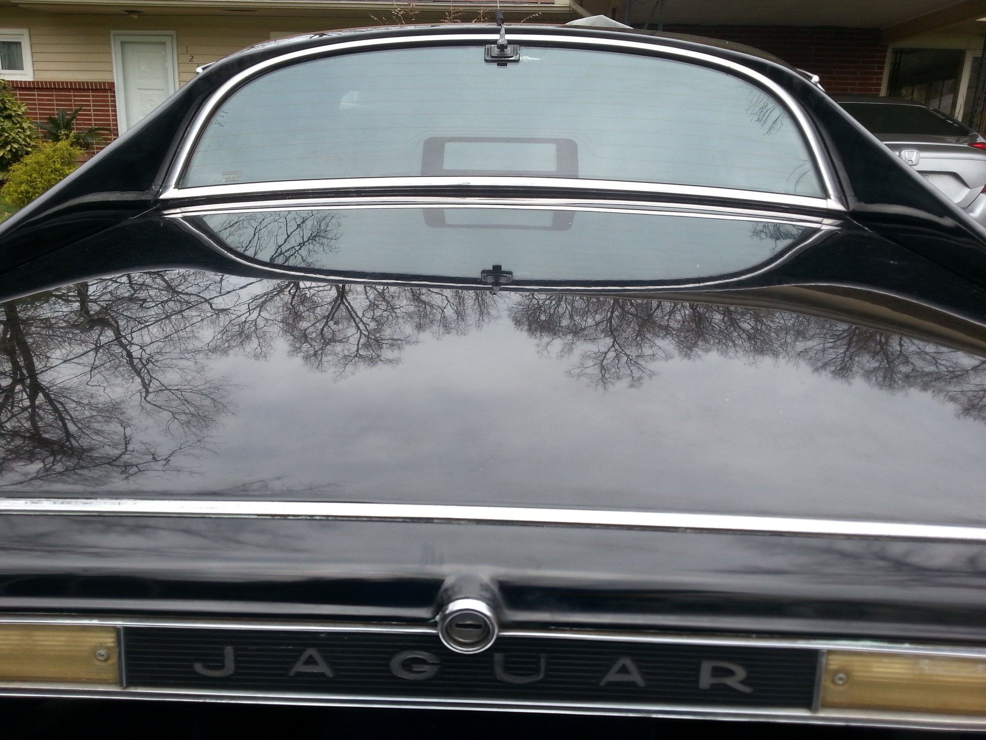

The rust on the leading edge of the trunk albeit not superficial, is well manageable! This is the immediate "before" image, I have cleaned it quite a bit since.

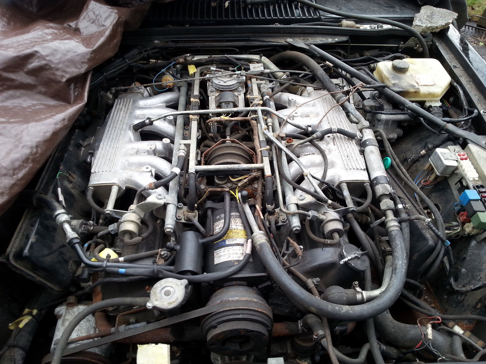

Well... I am in the thick of it now. (front of car now)
Rear of car is done ( fuel system)
I am removing radiator for general purposes( and to replace electric motor) so access to belts and crank nut is open. I am confused as to the direction that I am to turn the engine manually. ( I know the explanations I have seen seen simple, but I don't want any confusion on my part. I will have plugs out, and marvel mystery oil in each cylinder.
Replacing distributor, wires, plugs, The injector hoses are hard as a rock, so of course will be replacing all those lines, and I will need to bench clean and test all injectors.
I am removing the intake manifold to get all the buildup gone. Even though I don't know what to expect once I attempt to fire it up, I am going to go ahead and replace valve cover gaskets ( and inspect) since I don't want to have to go back and tear down that far again just to do later.
( I am already out some money on parts, anyway should unhappy noises occur upon startup and gaskets are cheapish).

Here are a few pics after initial clean up.
only back quarter panel cleaned, paint is ok underneath.
My only real question right now is if someone could be kind enough to tell me in no uncertain terms which direction I turn the crank.
