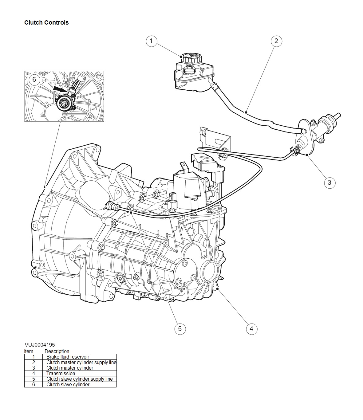

It's a interesting one.. The clutch pedal suddenly won't return, and we just left a pool of fluid all over a posh hotel car park !! There was no deterioration of operation, it just went wrong today.. Could be worse I suppose, at least it got us all the way here before breaking down on arrival. I'm thinking master or slave cylinder failure but either way it a relay truck home.

Graham. No wont be doing my own repairs on this one. It appears to be the slave cylinder which means gearbox out I understand.
Alan,
I was wondering why until I checked JTIS:
"The central slave cylinder is fixed to the clutch housing with three bolts, together with an integrated release bearing. The release bearing is a press - fit on the clutch slave cylinder............."
Who on earth dreamed up a setup like that!
