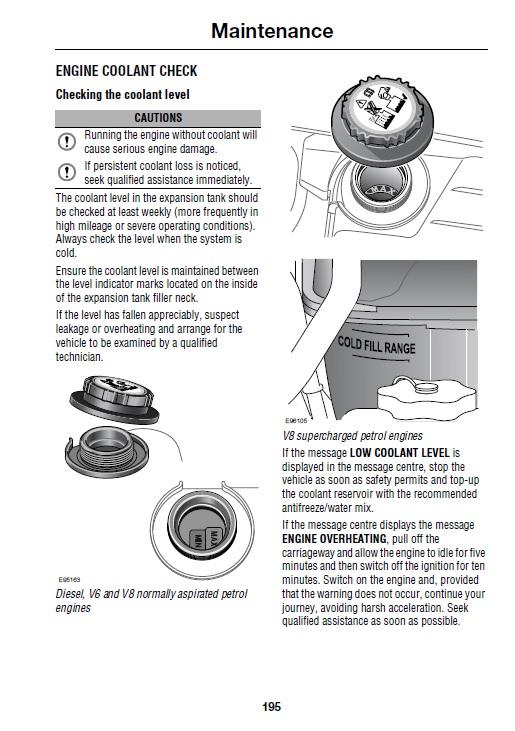

Originally Posted by NDN
..... There are no clear markings in the reservoir, so who knows that the ideal level should be. What else could be the issue?.....
Welcome to the forum NDN,
The 2009MY XF Drivers Handbook suggests the levels are marked both inside and outside the Expansion Tank ......
If the level is correct, the most obvious cause is likely to be the level sensor in the base of the tank.
