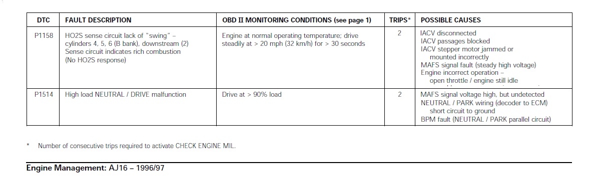

I'm Kev from Va. with my first Jag and i'm pumped. This to is a relatively well maintained vehicle with 142k miles. All fluids are ok, no leaks, engine and tranny are quiet. Check engine light appeared and had it checked;p1158 and p1514. I presume sensors, but I will hit the tech forum first. I have no service records, so I will put it on the lift and start with new filters and fluids.

Welcome to the forum Kev,
Not often we see those codes reported. Here's the possible causes for them from the Jaguar DTC listing:
