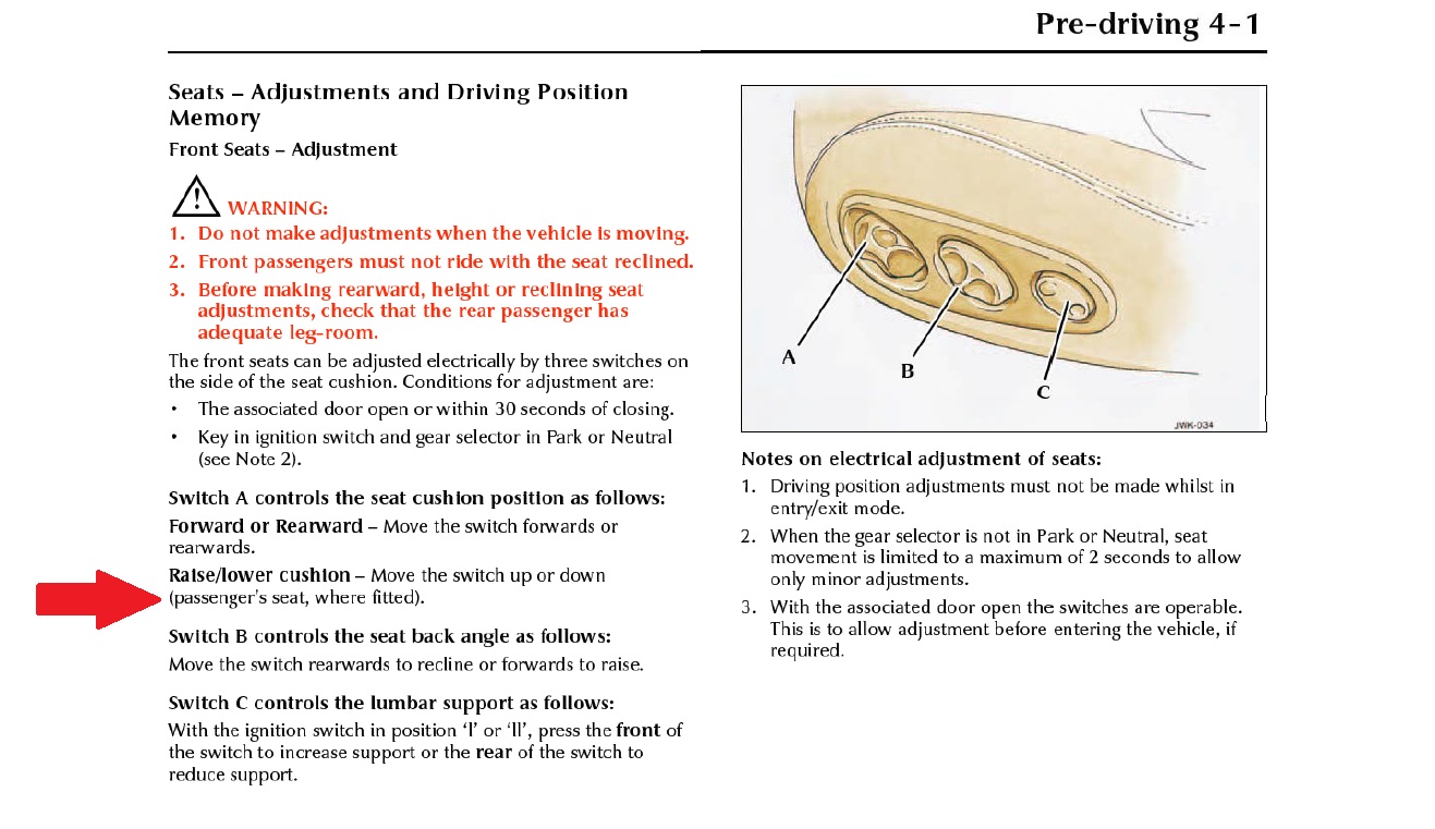

Hello,
This has been a great tool for me, I just purchased a 2001 xkr convert. w/ 23000 miles. The car is in great condition and the previous owner has serviced it faithfully ie. roof hoses, tranny service, brakes and tires. etc.
the one question I have involves the passenger seat. does it go up/down?
the switch feels to only work for the recline nothing happens when you try to
lift up/down, no movement in switch, ie [detent] feeling.
Thank you John47

Good to have you here with us at Jaguar forums. You may not have seat trouble - the Raise/Lower function depends on spec (see the line arrowed in red):

Thank you for the welcome and thanks for the explanation. Must not have that option on passenger seat.
Thanks again
John47
