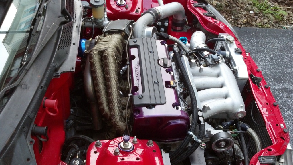

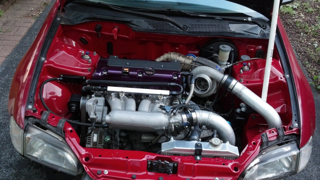

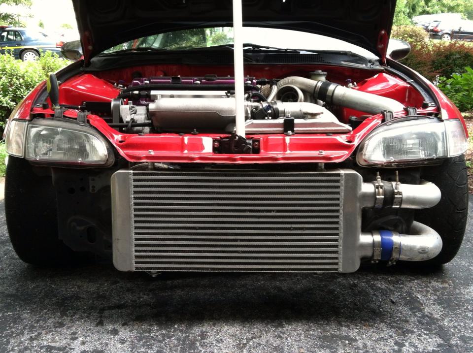

My Brothers Track Car. If There's Any Honda Guys Out There, Or Anyone That Digs Properly Built Cars, Then Check This One Out. Civic Eg, K24 Swap, Garrett 35R Turbo, Sleeved, Fully Built.

Very clean! I like how he kept it very simple looking, but the details are there if you know where to look. Why Drive train is he running? Is that a Fullrace manifold?

The Turbo Manifold Is Full Race. The Intake Manifold Is Stock Ported. The Drive Train Is A 6 Speed Civic Type R With Billet Gears. It Also Has A Custom Suspension Set-Up With A 5 Lug Conversion. At Full Boost(35Lbs) He's Putting Down 824Whp.
