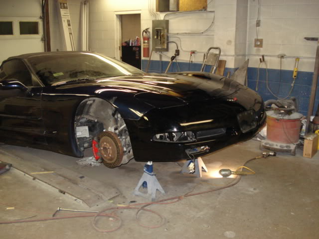

I started a thread over in the S-Type Forum titled Jag & Vette People. Thanks to those who expressed interest in my project. I purchased this 99 Convertible from Progressive Insurance. It has 71,000 miles, Six Speed Manual, Heads Up Display, Active Handling, F45 Suspension with Real Time Dampning, Dual Power Sport Seats, Bose Stereo with CD, Memory Seating and Column and maybe some other stuff I'm forgeting. Navy Blue in color with black interior and top. Currently has a set of chrome thinspokes but I bought a set of chrome C6 5 spoke wheels for it.
Some pictures of how I got it in a minute

I found all the parts to fix it locally at a good price. That is good because I over paid a couple grand for the car. The biggest challenge will be straightening the frame. I am working on a set of adapters to mount it on my machine. The frame is critical on these since everything attaches to it. Headlights, hood hinges, Upper control arms, lower cradle and the inner fenders get glued to it. So it has to be right or nothing will line up.
It may be a while for an update as I have other things to do. But I really want it done for next summer and hopefully the local Jag & Vette show in June.

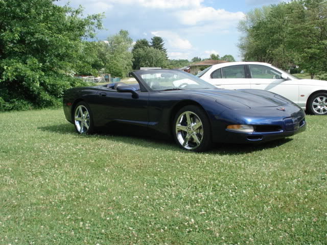

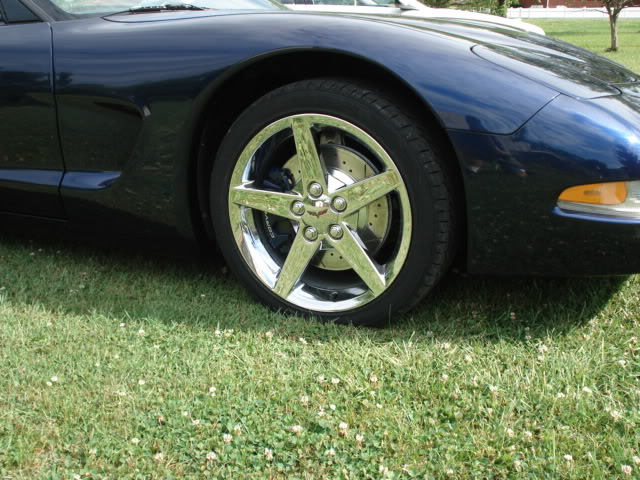

Some pictures of it now that it's on the road. C6 Chrome wheels, Hankook Ventus V12 tires, new drilled & slotted rotors w/ceramic pads. Also blasted and painted the calipers dark blue to match. Drives like a dream. Ride of a Cadillac but goes like a rocket.
